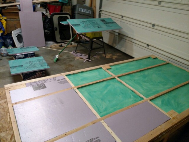

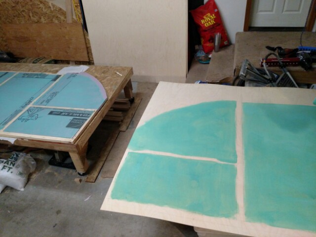

Postby yrock87 » Tue Apr 26, 2016 5:35 pm
so it turns out that I am using a LOT of this stuff. I have finished the floor and walls and have maybe a quart left. I don't think I can finish the front wall/roof and hatch with what I have. I am brushing on and following the directions as far as coverage /drying.
thanks for all the advice on heating up the shop and having a second set of hands. both tips turned out to be invaluable. (waiting almost 1.5 hours the first time because the humidity shot up as the outside temp fell stunk)
anyways, wanted to give some feedback on my original question. turns out that to glue both outside and inside sheathing to foam for a 5x10 tear you will need at least a gallon. at least that is my experience.
gotta match up the contact cement and allow room for the tightbond II on the wood framing
my floor half way attached
yrock87
Posts: 286
Images: 97

Final update on the 3m fastbond experience. I have about half a cup left from my original gallon. I used it to bond the inside and outside ply to foam on the floor and both walls, so a little less than 250 Sqft total. I had enough to glue the foam to the inside ply on the front wall/roof, but I will not have enough to apply the outside ply on the front wall/roof. I also did not do the hatch or the bulkhead with 3m fastbond. So I would need another quart to half a gallon to finish.
Also I probably should have used more on the wood side of my bonds, I put an extra coat on the roof and it has preformed much better than the walls and floor did. But that uses even more product!
I cannot say what would work better, but I will be trying my hand with PL Premium adhesive to finish the roof and build the hatch. It is not worth it to spend the money on another 2 quarts of 3M fastbond. I wanted to love it, but either due to my technique or to its own limitations I have found it less than ideal. Especially when you consider the price.
