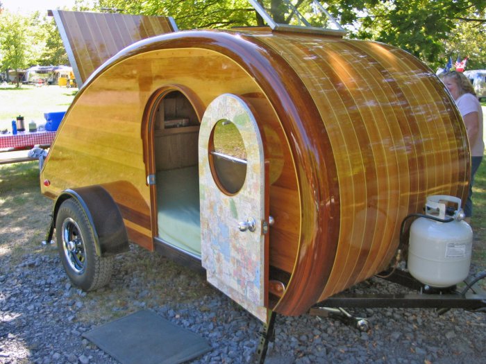

For UV protection, nothing beats a good quality marine spar varnish with periodic maintenance. Having said that, on my tear I shot it down with three layers of auto clear coat. That has worked very well for over 6 years on areas where there is cloth. On the sides of my trailer, I did not use cloth, and the clear coat was too brittle for the movement of the wood. Good spar, or auto clear coat, might cost as much as the epoxy....but I would guess $150 by the time your finished laying on coats and sanding between. Again...dont relyu on my best guess estimate...

Postby tony.latham » Tue Jul 19, 2016 4:12 pm
Juneaudave wrote:Welcome!!! I have a couple thoughts....
Epoxy and cloth....I've used West, MAS and RAKA over the years and any of those would work well. I typically buy the slow hardener for clearcoating so I don't have to rush. For cloth on a tear, I like the RAKA 4 oz plain weave. They have good customer service, its cheap and they used to carry 4 oz in a 72 in width (I only saw 60 inch when I checked). I dont think you need 6 oz for strength, and if you go lighter than 4 oz, it gets pretty tender for handling (ie it will snag very easily as you lay it out). Dont rely on my estimate, but I'm guessing epoxy (1 1/2 gallon), cloth, pumps, brushes, rollers, mixing cups and sticks, etc at about $200.
Hope that helps!!!
Dave:
Your closing argument –– with that photo–– wins hands down. At least for me. (Interesting on the clear coat on the fiberglass but not on the un-glassed wood.)
