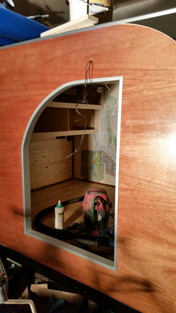

So, after a coat of epoxy, then 4/5 layers of spar urethane on top of mahogany plywood - I am done. Now would it be prudent to add some final coat, say a Johnson wood wax, to add that last additional layer of protection?

dakippen wrote:So, after a coat of epoxy, then 4/5 layers of spar urethane on top of mahogany plywood - I am done. Now would it be prudent to add some final coat, say a Johnson wood wax, to add that last additional layer of protection?
  • Would I be considered out-of-line to suggest bed-liner? Just kidding, it would be a crime to cover that woodgrain, especially after the epoxy work. At one point, in my TTT build, after using the poly "mix" and multiple follow-up coats of Minwax polyurethane, I was tempted to leave it with woodgrain showing. I liked the look, but knew the Texas sun would destroy it rather quickly, so I stuck to my original plans to paint over the poly with silo paint and tractor paint, formulated for high UV resistance.

  • I think that a good coat of wax isn't a bad idea, used for running the initial interference against the elements, but probably not as useful as keeping it clean, and covered (by car cover, tarp, or in a garage). Good work, and good luck.

[list][*]Would I be considered out-of-line to suggest bed-liner? Just kidding, it would be a crime to cover that woodgrain, especially after the epoxy work. - Yeah, not happening on that part ;) The spar urethane I used does have UV protection....so I don't know if that will make a difference or not.
