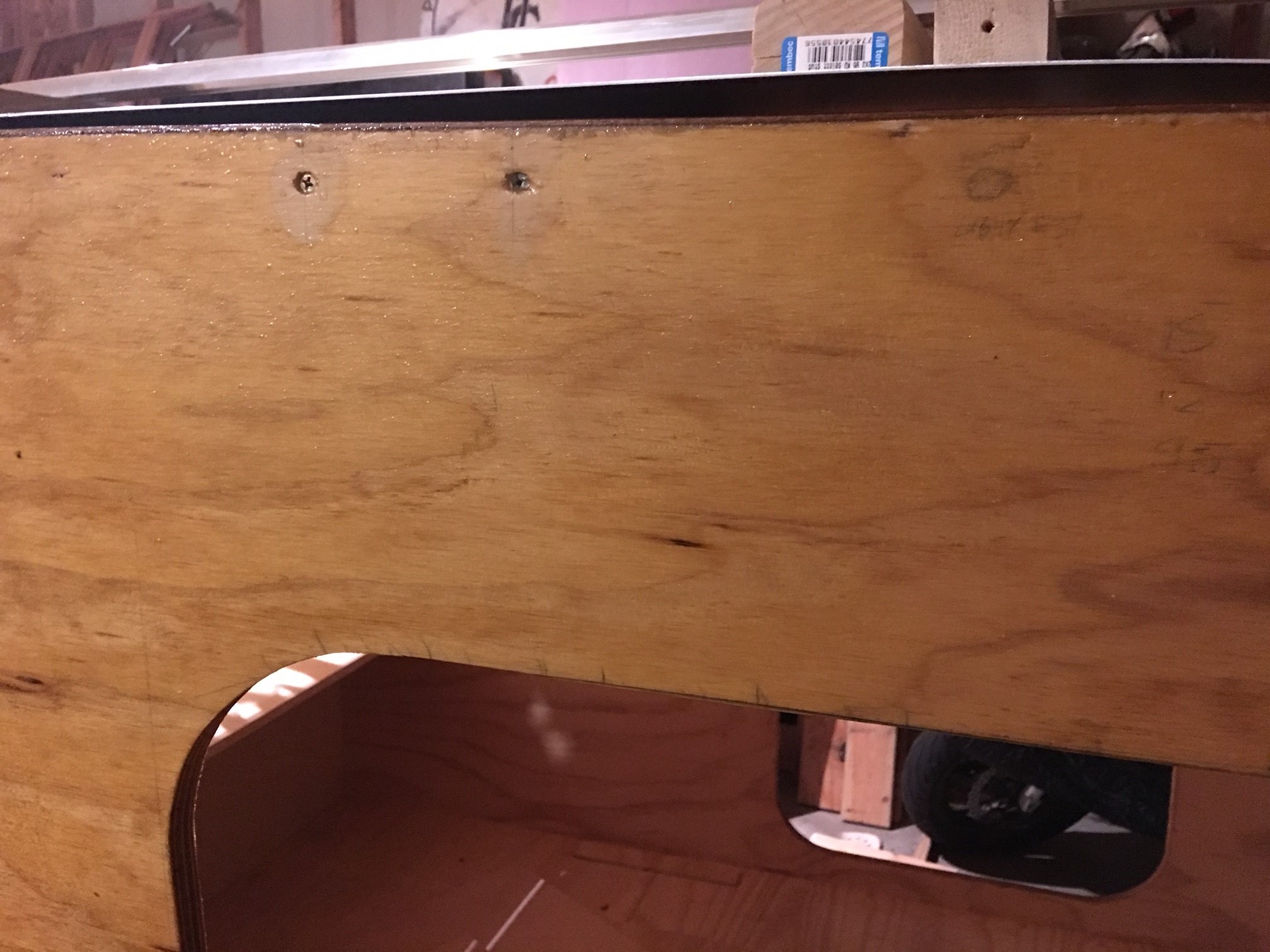

Hi Guys,
I need some help or input from those that have skinned. Last night I attempted to install roof aluminum (0.040in) and having some trouble getting it to lay flat or flush and stay there.
I followed suggestions of fastening with screws at front and then pulling back towards final hinge spar with straps but it doesn’t seem to want to pull down. I still have big “bulges” or pop outs after tightening. I don’t want to screw it on the back spar if not tight. I am not using any adhesive, nails or stapes. Simply screws at front bottom edge and rear spar.
So my question, how tight/flat/flush do you guys get it? Does it need to be essentially perfectly flush and flat all across faces of roof? I seem to be able to get the edges tight if I push or clamp but I worry that towards the center it is puffing up.
I obviously plan to install edge trim but cant yet without the side skins installed. (I'm hoping this will help "pin things down)
Thoughts? Suggestions?
I tried to get some pictures but was too dark. Here is one bad one…
td al.jpg (572.76 KiB) Viewed 2518 times

Try using some "stickers."

Thanks I actually based my first attempt last night off of your picture below but perhaps i didn't have enough braces.
I assume by stickers you mean the wood braces?
The other issue i ran into was that where my straps were putting pressure on my rear galley cabinet :( so i was worried it was going to damage it.
As a follow on question, after you get it tight and screw into the last spar and remove straps, does it pop up or "spring back" ? Or stay tight forming to the profile.?
I thought I responded. You've probably got it all down now.
It still floats of course but there should not be much spring-back when the trim is on.
T
