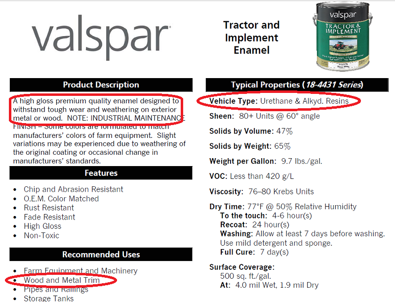

  • Though I used my alkyd-resin based paints over plywood already thoroughly coated with the "mix", and pure polyurethane, similar alkyd paint (or stain) would probably work well for you. After a lot of research into coatings prior to my build, I arrived at using Valspar alkyd paints (re-branded as Tractor Supply) as my best choice at the time (yes, in 2011 I thought it was the way to go, also). Locally available anytime, inexpensive enough for my low budget, and trusted by me and my grandfather (who always used Valspar products for many years). As it turned out, after five years since painted, my trailer has held up well (though garaged 95% of the time, it's still exposed to heat and cold and pervasive dust). It's been in many heavy rain storms, and exposed to blistering sun (I get the blisters, not the paint on the trailer!), so I'm very pleased with it. I fully expected to over-coat it later, with bedliner-type material, if it failed, but so far it has been flawless.
  • I used two types of the Valspar-TSC paints: tractor and implement, and silo paint, and still have a liitle left (bought two gallons of each; though, since they have been stored in the un-sealed garage so long, I probably wouldn't use them now). Tractor Supply has switched to Majic paints, so I can't attest to their formulation, but the Valspar alkyd formulation is a good one.
    valspar-TSC re-branded alkyd-urethane paint.PNG (248.96 KiB) Viewed 2416 times
    I used the "Massey Ferguson Grey" color

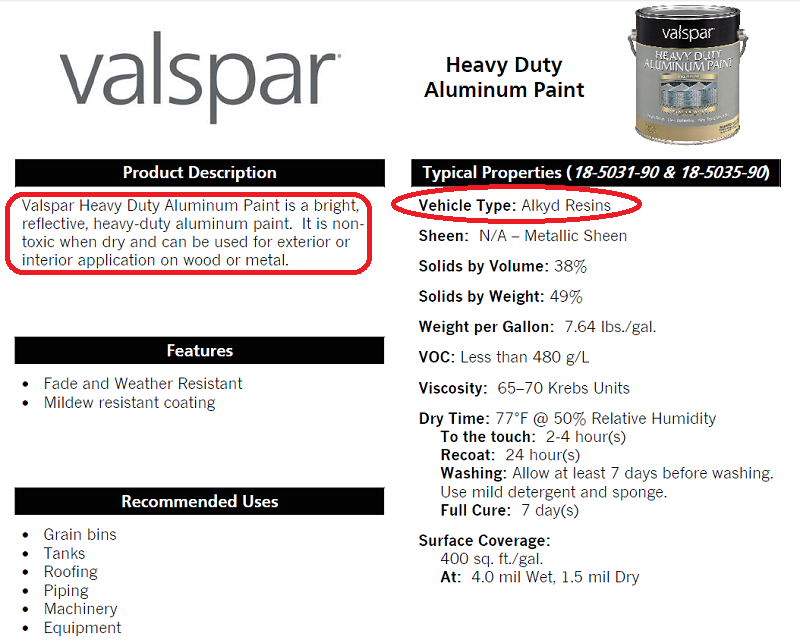

    valspar alum silo paint.PNG (207.98 KiB) Viewed 2416 times
    this reflective paint is on all upward-angled surfaces (even the hatch points up when opened)
