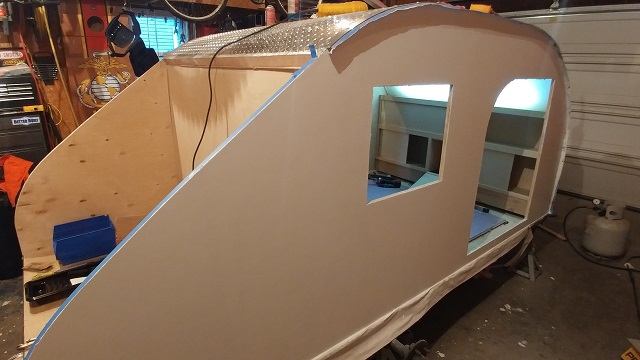

I just skinned my trailer using pmf. I first sanded down all the plywood on mine and filled in low spots with great stuff(I do not recommend this stuff at all). I then poured the Titebond II into a paint roller pan and used a roller to apply the glue to a side. I then took a sheet of drop cloth material and adhered it to the glue using a scrap piece of 2x4 to help smooth out any wrinkles. The last application I added the roof drop cloth which rolled over the side edges and across the front.
After everything dried 1 day of 75-80 degree weather. I started the paint using a roller until everything was saturated. About 3 coats have been applied. Paint I used is exterior latex one coat paint.

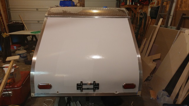

Thanks! I have already done the sides, I did use the big box store canvas. Shrunk it at the laundromat and ironed on the dining room table. Went well enough and pretty smooth, no ironing on the trailer. Got a couple coats of primer on and working towards the exterior coats. I did just order the canvas from bigduck for the hatch as that is the part I want to turn out looking as good as possible. Thanks for the info, I wish I would have looked harder for a supplier It would have been nice to order all from them. Im happy with how the cheap canvas is progressing, so looking forward the using theirs. :thumbsup:

Sure is, way better quality canvas than the box store drop cloth. I bought the preshrunk http://www.bigduckcanvas.com/10-oz-cott ... s-natural/ I did my sides with the box store and my rear hatch with the stuff from big duck. Huge difference. I also used different paint on the rear hatch, oil based topside paint. Used sand able filler primer on the rear as well. Sides I went latex exterior paint.
