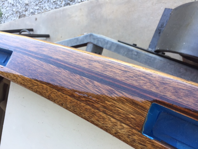

most of the above mentioned "marine" finishes will provide a reasonably good result
the issues experienced by most who complain were caused when they did not do their due diligence when it came to SURFACE PREP
the BLUSH must be addressed and totally eliminated
then the entire surface requires fine sanding
sanding involves scratching(minutely) the ENTIRE surface to the point where it has changed color to a chalky grayish/whitish color(indicating there are no unsanded spots remaining) and smooooooth to the feel w/ the naked hand
¿ did i mention SANDING ?
once sanded several(3+) coats of varnish applied according to label instructions will provide UV protection
some products require specified curing time + sanding between coats
some work well when HOT COATED(additional coats applied within a specific time window which is prior to complete curing and w/o sanding between coats)
NOTE: some epoxies on today's market have UV inhibitors already in them CHECK WITH THE MANUFACTURER
using UV inhibiting epoxy could save you a substantial amount of work time & $$$...
the attached pic was taken after the solid mahogany and edge grain marine fir plywood were sanded down to the wood and 2 coats of UV inhibiting epoxy were applied using the HOT COATING method(after sanding the total coating time was less than 24 hours)
sw
