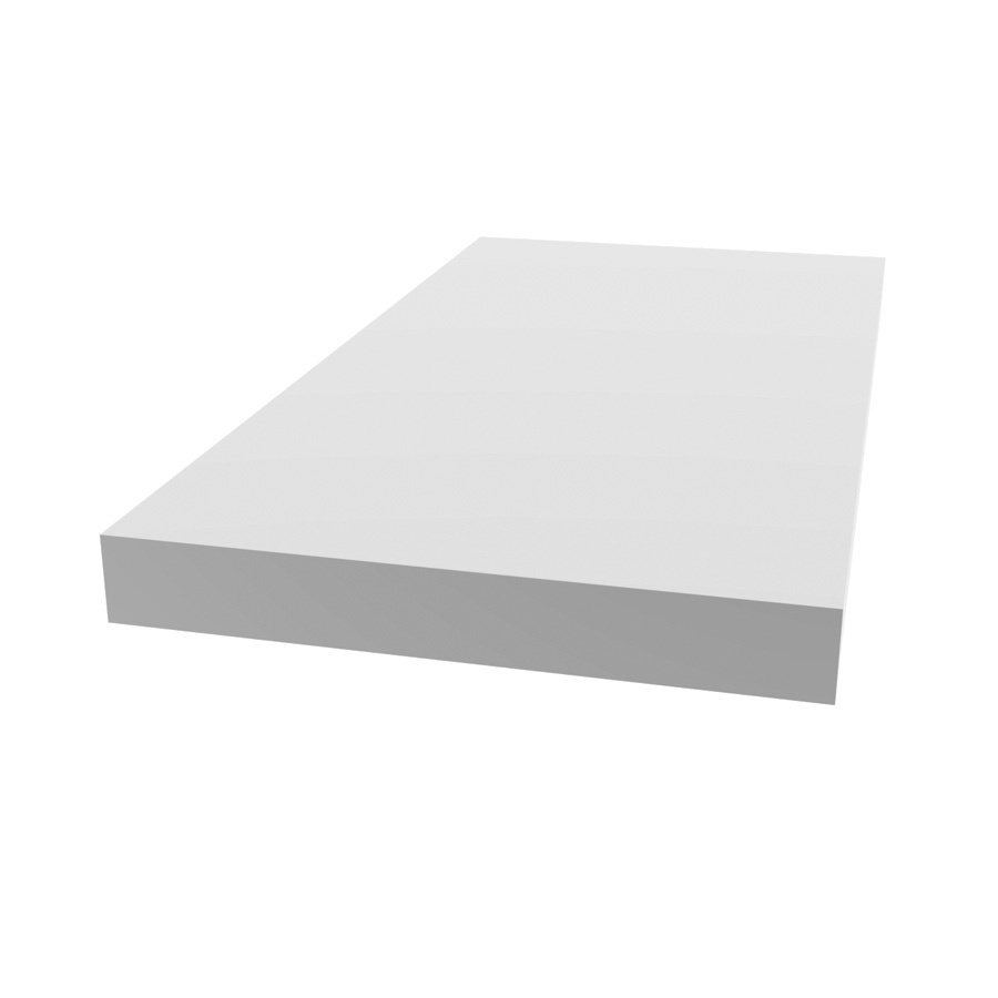

https://www.lowes.com/pd/EverTrue-Commo ... 1000443085. I have used this or something similar as a drip edge. It is pvc so no rot and its waterproof. if you want to paint it scuff it up and use a good primer first.
