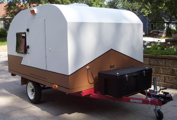

I have used a mixture of epoxy/acetone for my camper and a small plywood boat build, about 50-50. Then painted with latex primer and latex house paint. The boat, built from $8 luaun is still looking good 17 years later after living outside (Minnesota) and getting a new coat of paint every 5 years years or so. The camper was sold. I will again follow the boatbuilders' recommendations for painting with latex paint on my current build. You can learn a lot about finishing wood with epoxy and latex paint from searching the web on homebuilt boats.
I tried to find out on this forum about using latex paint over The Mix but no one seems to recommend that. I can see why since paint thinner is pretroleum based. I will continue to use an epoxy/acetone mix. It works well and cures overnight.
This is not the most clear picture. I wasn't trying that hard for an amazing finish on my first camper. This time I will use a better color.......
