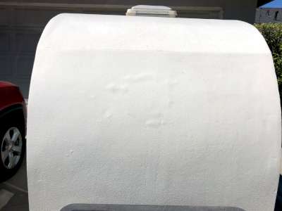

Hi friends,
Last weekend I bought a homebuilt teardrop. It will need a little bit of love to make it shine.
The front wind facing outer skin has some bubbles in it. It's like the PMF came apart from the plywood but the PMF has not broken. I'm assuming I need to fix this or eventually water will enter, yes?
So my question is how do I fix this? Can I cut the bubbles out, sand, and then re-PMF, sand again and paint?
Thanks for your help!!
Julie in SoCal

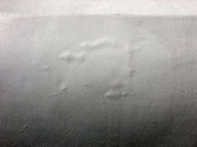

Postby Sanuk.Sanan » Wed Sep 18, 2019 2:41 pm
Thank you, friends, for your kind replies!
A couple of comments:
1. It was very hard to poke a pin through the PMF. It was very stiff. Eventually, I took a nail and I could lightly hammer it through. I can't see jack through the hold, though.
Here's a couple of pictures of the bubbles:
Now that I've taken a pix of the problem and developed it to show the defects, it seems that this is not a new problem, and the previous owner tried to fix it, too.
Besides the aesthetics, how bad of a problem is this?
Thanks for your patience. I'm still learning all of this.
Julie in SoCal

Postby RJ Howell » Wed Sep 18, 2019 3:12 pm
I don't see it as a All-is-lost thing. Just something to be dealt with or live with.
I agree with puncturing the bubble. Resistance to the paint is one thing, yet if it's plywood than that's going to take some effort. If you can puncture and press it down with your hand easily, should just be fabric. I've used my hypodermic needle to inject glue/paint and press/clamp it. That has worked for me. On a curve like you have, think of something tall enough to reach the bubble and something stiff enough yet pliable to form the curve and place shims (of whatever) to hold it against the wall. My thought goes step ladder, 5 gallon bucket with water for weight, rags and cardboard as filler/shim material. Wax paper on the skin to not glue whatever shim material you use to stick.
One bubble at a time to work out the system of repair.
Hope this helps..

Postby Sanuk.Sanan » Wed Sep 18, 2019 4:03 pm
Hi RJ,
Thanks. I can puncture and press it, so I'll see if I can get some glue in there to fix it. I can probably build a jig to hold/clamp it with bungie cords and flexible plastic. The wax paper's a good idea. Thanks.
I'll give this a try and will post pixs when I"m done.
Thanks again,
Julie in SoCal
