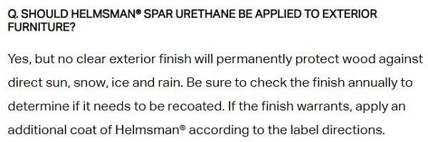

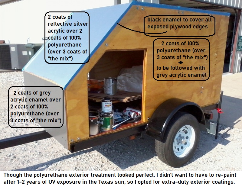

* I also used 3/4" plywood from a big box store (HD), and chose not to install insulation, either. When it came to exterior coatings, I chose to go simple, and use polyurethane and acrylic exterior enamels (both of which I had used several times before, with success) instead of trying a bedliner-type coating (it was my first choice, but I wasn't sure enough of it's efficacy on wood to try it), or attempting again to use epoxy or fiberglass (both of which had given me trouble, before).
* Once I learned of the fabulous "mix" (polyurethane mixed with paint thinner), and its' ability to soak into and "plasticize" wood, making it pretty well waterproof, then I decided on using it as a base coat for any topcoat to follow, by bedliner, or by spar urethane. When I researched UV problems with those coatings, I arrived at the choice of tractor enamel and silo paint, instead. Of course, having a ready supply of those at the nearby Tractor Supply Co. made that choice easy.
spar urethane limitations.JPG (61.49 KiB) Viewed 8870 times
* By the time I started to coat the exterior, I had already bought several gallons of each type & color, so even though I momentarily wavered between leaving the woodgrain un-covered (the shiny clear polyurethane made it look great), I wa already committed to the enamel plan. It did look very nice, and if I had used a more premium wood choice for the cabin, then I might've tried epoxy after all??
covering the pretty polyurethane with durable coatings.jpg (211.89 KiB) Viewed 8870 times
* I have no regrets following the course I took, since the paint over poly has lasted so well after 7 years (my trailer resides 90%+ of the time in the garage). I've only had to retouch a couple of spots that received incidental contact damage in the crowded garage bay, but that repair work might've been more costly/difficult to ameliorate, if I had used epoxy, fiberglass, bedliner. or PMF instead.
