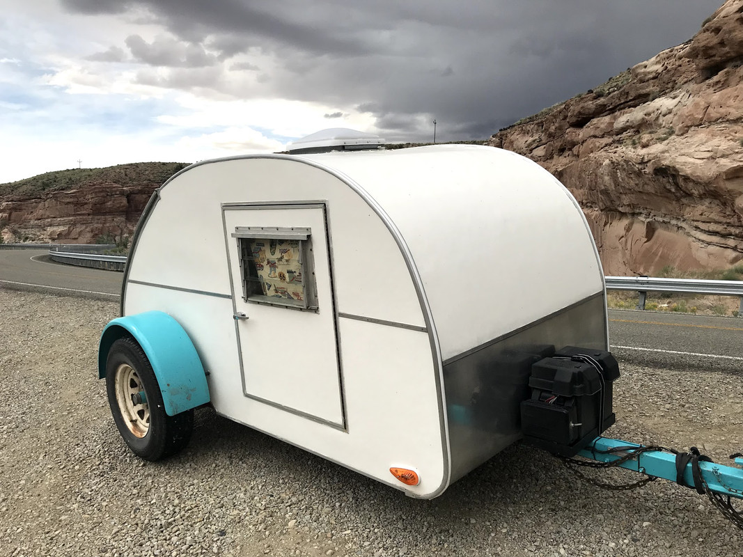

Hi I am writing to report on my use of fiberglass reinforced panels (FRP) as siding on my teardrop trailer. This is not a recent build. Rather it was done when I originally built the trailer 20 years ago. This covering is still going after 20 years without a single leak occuring during that time. The trailer has always been stored outside.
The material is the same stuff used in countless gas station bathrooms across the country. It is the bumpy, shiny white stuff. Instead of having the finished (bumpy) side facing out, I installed it with the smooth back side facing out. A word of caution; When I installed mine, I liked the soft white color of the smooth back side of the panel when it was on my trailer so I just left it as is without any paint. Over a few years the ultra violet waves caused fibers in the surface of the paneling to fray and lift. I was planning to replace the paneling again with the same product but this time I was going to make sure that FRP was painted to protect it from UV light. As a temporary stopgap so that I could use it for one final season I painted the old surface with a couple of coats of Rustoleum white oil based enamel in the roll & tip method. That paint is still going strong a year later so I plan to wait another year before replacing the paneling.
When I originally installed the paneling to the 3/4 plywood body, I used contact cement to glue the paneling in place. I was never satisfied with the result. It hasn't give me any trouble but I can see wavering in the surface that indicates the panel has lifted there. I am not worried about it coming off because it is trimmed in with extruded aluminum all around the edges doors and and window When I do it again, I will use a slow set epoxy resin after quickly running my orbiter sander with a course disc over the tops of the bumps on the shiny side to make sure I get a good bond. So here is a pic of my 20 year old trailer. It was taken at or near Capital Reefs National Park, Utah while on a trip to Northern New Mexico.

If you can find it in your local I have seen listings online for FRP that has a smooth finished face. I think that shiny surface to be gel coat which should be much more UV resistant. Especially if you wax it on a regular basis. I haven't seen it anywhere around here so assume that I will go back to the same stuff next time a with an outside coating. I am very happy with the white Rustoleum. I think it is more resistant to fading than the same paint of other colors. One could also take a que from fiberglass boat builders and use a quality polyurethane marine paint as an excellent option. It would especially work well by application by the roll & tip method since it will flatten out better after the final brush strokes.

I see FRP as fiberglass in sheet form. It eliminates all of the effort and mess of laying up multiple layers of cloth or mat.Not to mention the work required to bring that fiberglass to a smooth enough surface to be considered finished. The backside surface of FRP is smooth and is ready for paint without sanding.
My corner molding is standard RV extruded aluminum that has slots on each side of the upper surface that accepts a vinyl plastic molding strip which covers the screws for appearance and exposure to the elements. I used high end RV caulking that at about $18 a tube was very spendy 20 years ago. It was worth the cost given that I have had no water intrusions over that time. I thing the standard method for sealing this type of corner trim is to use butyl tape. However I doubt that butyl tape would have lasted 20 years.
The lower front panel is aircraft aluminum sheeting that was given to me as a leftover scrap by a buddy from his teardrop build. It makes a great gravel guard for the front of the trailer. The horizontal strips of extruded aluminum trim down the beltline of the side the side was added by me as insurance for that previously mentioned lack of bond between the FRP panel & plywood. I am convinced that this trim could be eliminated if I used a epoxy resin as an adhesive. But I like the looks of the trim in that if gives a 40's-50's flair to the looks of the trailer.
