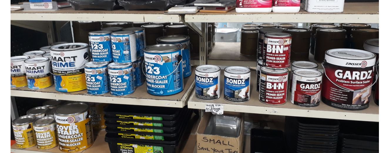

I remembered the local paint store has quite a range of Rustoleum pains, so I went there this morning and found they have some of the Zinsser range of prep coats (these come via Rustoleum Australia).

The Smart Prime datasheet says it has excellent adhesion to enamel paints and varnishes.
The Bulls-eye 1-2-3 looks OK too. Both say to not use on decks, areas subject to immersion or in prolonged contact with water.
The Bulls-eye 1-2-3 datasheets says it "provides excellent adhesion to dense glossy surfaces, enamel paints and varnishes, panelling, laminates and ceramics without sanding or deglossing."

Came to work next day to find emails from 2 different people..
"Don't use the bulls-eye 123 or the smart prime, Zinsser Cover Stain is the one you want for that application".
"We recommend cover stain for painting over polyurethane varnish".
No ifs, buts or maybes - just "use this one"
