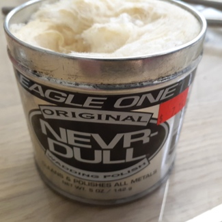

Postby twisted lines » Tue Dec 08, 2020 9:41 pm
I remembered seeing your thread, but it took me a while to remember at the right time.
If you master polishing tell no one. This is comparable to mothers it will make a mirror polish but I like power tools.
Something about the juice! Cleans & Polishes all metals (can say's) sounds like you should clean,
Matching is the hard part about the other. No I haven't done / never will do a piece of a Air stream but if you don't like it let her try it on glass water spots, you won't get it back :lol:
Eagle One.jpg (45.74 KiB) Viewed 2797 times
