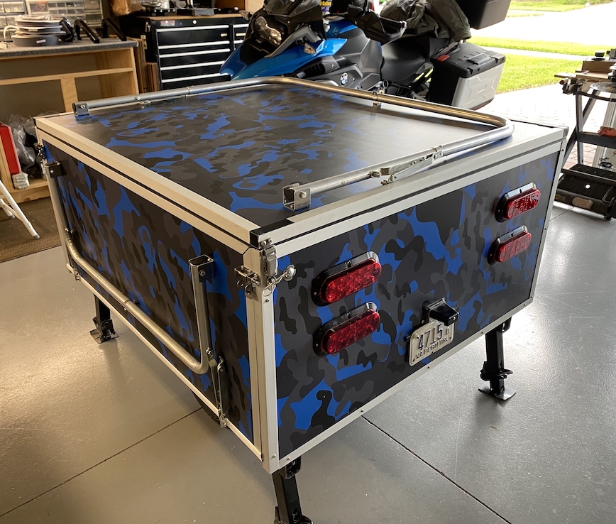

Here's a look at the vinyl wrap on the camper. It turned out great and I'm really happy with it.
Vinyl Camper Wrap.jpg (551.84 KiB) Viewed 3249 times
I used a water-based primer/sealer on the wood, sanded that, then applied 3M's tape adhesion primer. The 3M primer dries to the touch in seconds and is then ready for the wrap. The wrap applied easily. This wrap seems to release trapped air bubbles a lot better than older wraps I've messed with and with a little heat applied from a blow dryer, it really grabs the surface.
If you look at it from an angle you can see some of the grain from the plywood (not in this particular picture, but when standing in front of it). It is for this reason that I went with a wrap that had a pattern. If I'd wrapped the camper with a solid color, I think the grain would have looked bad. On the camo, you only see it at an angle, and I think the grain and wrap pattern complement each other. Next time I think I will use digital camo because the highly pixelated pattern would make wood grain even harder to see.
The only immediately apparent downside to it is that it's susceptible to dings. When installing screws into the latches my screwdriver slipped a couple of times and hit the vinyl, leaving a couple of small punctures. On the plus side, the camo pattern made it easy to fix. I cut a couple of small coverup patches from leftover material and covered the "Doh!s" quickly. What holes?
I'm not really worried about that because it's a camper and while I want it to look nice a few nicks here and there are like camping achievement badges. I also understand that vinyl won't stand up to UV exposure like paint or powder coat, but when not in use this camper will be garage stored. Besides, if those spots had been covered with aluminum skin and I'd done the same thing, I'd have had a bigger issue.
So I feel like this was a better solution on the whole for this application. It really looks good with the bike.
