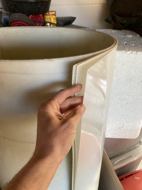

Hello, I decided that I want to skin my build with these 5'x10' fiberglass sheets/panels I purchased from a guy in Central NH. They are strong and flexible, with a little bit of weave texture. My hope is to frame up the camper, attach these panels directly to the frame, then have the interior professionally spray foamed so that the frame and skin are monolithic. I feel this would make it light and rigid. Does anyone see any potential for problems? I'm thinking about gluing the sheets to the frame then using some screws on the perimeter to hold the edges down along where I will ultimately use aluminum trim. The reason for glueing vs screwing is to avoid dealing with painting over fasteners. Not sure if this system will want to make the fiberglass bubble out between the studs. Also, anyone have a recommendation for a durable system to paint the fiberglass? Thank you all for your help. Just beginning construction of our family camper and this site has been great.
