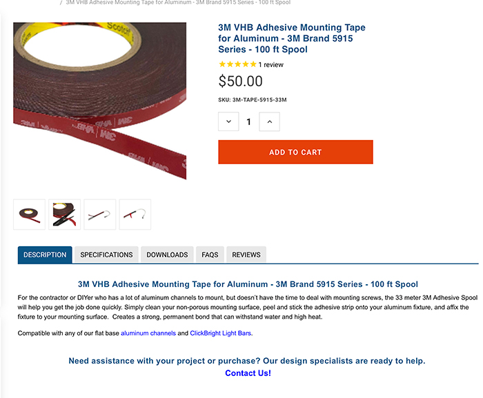

I'm waiting for contact back from 3M to ask about best tape for aluminum and my application. In the meantime I did read that
the tape used should not be more than 50% in thickness in the materials being bonded (this specifically said for dissimilar materials
but I'll use that same strategy even though my aluminum is similar thickness---.040).... which tells me the tape should be .020 or less.
I did find one tape (noted in attached picture) for aluminum, although this is only available in 1 inch width. So still researching it and will
look to talk with 3M.
