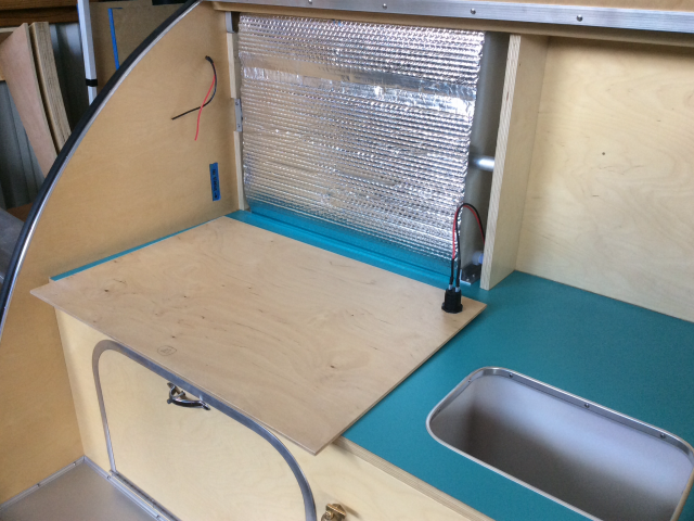

I wrap my poly water tank with the foil faced bubble wrap as a moisture barrier to prevent direct contact with the surrounding plywood. Since the water tank will sweat in high humidity it seems like a good idea. I don't think of this product as a substitute for bulkier insulation (like the foam panels you mention) and would stick with something that has more loft and R value.
