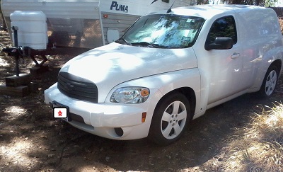

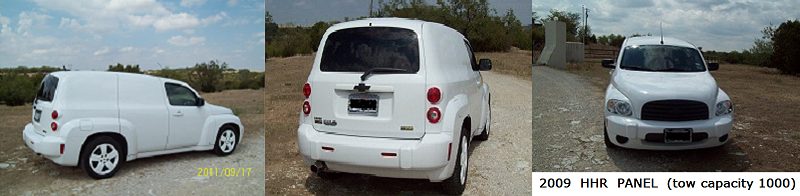

I used rattle-can Plastidip (black) on the plastic grille on my '09 HHR Panel, back in the summer of '11, to cover the hum-drum argent silver grille color found on everything Chevrolet, back then. I also used Krylon white plastic paint on the argent silver wheel covers, just for a monochromatic effect. The wheel cover paint lasted just about four years, before I swapped in a second spare set of silver wheelcovers, but the Plastidip grille remains OK (a few damaged spots from stone damage, though, but unnoticeable from 20 feet away).
picture taken a month after Plasti-dip, Krylon paint 9-17-2011
hhr panel at the ranch.png (314.66 KiB) Viewed 1386 times
closer view
HHR Panel.jpg (61.8 KiB) Viewed 1386 times
I sprayed the grille after cleaning it with a grease-remover (?? brand), then used 1.5 cans over two days to fully coat/dry/coat/dry completely, while the remaining 1/2 can went onto my trailer fenders as a touch-up coat. I've never re-coated the grille, and after 11+ years and 165000 miles since spraying it, I'd use it again without hesitation.
