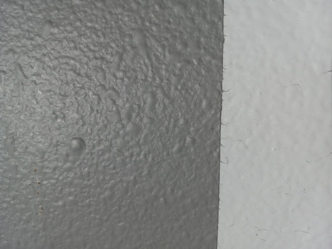

Postby twisted lines » Mon Feb 20, 2023 5:11 pm
To apply over it, Skuff it with the brown scratch pad provided, Clean with MEK if its not available in your area smuggle it :lol:
They offer an alternative; Haven't used it.
Mine is white top /front; with gray sides, Rear (had to look)
I sprayed and plan for it on #2
Yes the colors are plentiful :thumbsup:
Racking up; And Rapin foam

Re: Monstaliner design question
Postby twisted lines » Mon Feb 20, 2023 7:16 pm
flat split.jpg (59.8 KiB) Viewed 1386 times
Yes
Postby tony.latham » Mon Feb 20, 2023 8:40 pm
Yes
That's a nice job. :thumbsup:
