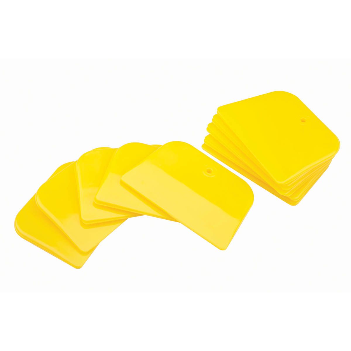

many get suckered into using the high priced spread when poxifying glass fiber
1st off you need to dedicate some TIME for this step
then you begin w/ pre-coating the wood w/ pox using a squeegee
i like the yellow ones from the auto paint n body supply store
using a brush get the pox on the wood and spread it w/ the squeegee
allow to just get tacky
spread out your glass cloth and squeegee a thin coat of un-thickened pox to eliminate all white unsaturated cloth
allow to become just beyond tacky butt knot yet cured and apply another coat of pox w/ the brush/squeegee method
when this coat has almost cured mix a light slurry of pox and wood flour(not saw dust) and apply it the same brush/squeegee method
repeat until the fibers are filled then do one more coat of un-thickened pox
allow to cure and sand for your chosen final finish
wood flour can be had from duckworksbbs.com for chump change
the time for the pox to almost cure depends on the hardener speed along w/ the temp & humidity
if you allow the pox to cure between coats you will have to wash the blush off and sand it before re-coating which is a major PITA
this process is called HOT COATING and drastically reduces your overall labor time
