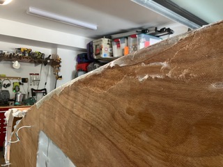

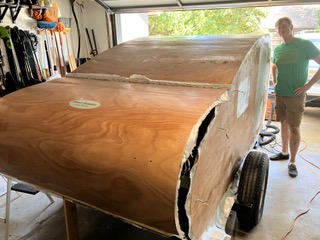

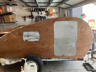

Thanks for everyone's input. it was all really helpful. I think the foamy gummy stuff was from too aggressive squeegeeing and I was just using a small piece of fiberglass so there was a lot off fraying at the edges that sort off turns into a gross substance. We are using a slow hardener since we have never done this before, more time seemed like a good thing.
We got 1 coat on. we cut all the cloth pieces and then did the top first to avoid touching the sides when they were wet. I think that was a mistake. The epoxy dripped over the edge and down the sides. We worked pretty fast, but it is a big area and we are newbies, so we weren't fast enough. By the time we started on the side, the overlapped fiberglass was hardening and was never going to adhere to the wood.
We ended up, after a fair amount of swearing, cutting off the overlap as close as we could and putting the epoxy on the sides without overlap. the roof edge looks terrible. We plan to finish the top today with 2 more coats of epoxy (it does look great) and this will let it all dry fully and go back and wash it with soapy water to avoid blush (not really sure I understand that it but it sounds important so we will do it), sand it all down and use 6" wide fiberglass tape to repair it and then finish epoxying the corners and sides.
I don't think we will win an award for technique but I think we can salvage it and it will be fine. It isn't a rocket ship after all (stole that from someone one this forum and thought it was a good thing to remember throughout this process

With cured epoxy, use a cabinet scraper to level the high spots. It's hard to sand down a high spot without sanding the area around it. If you don't know what that tool is or how to sharpen one (essential on fiberglass because it dulls quickly). You can use a paint scraper which is easier to sharpen and will work, just not a well or as fast.
Too late for you but it may help someone else: I would do the sides first and let the top edge of the cloth run over. With the epoxy not fully cured but not sticky, cut the glass flush with the top with a razor knife. If you catch the epoxy at the right point it's very easy. If the knife drags or gums up the epoxy is still too soft.
Then cover the top with epoxy/cloth. If you radiused the edge with a 1/2" or greater radius round over bit, you can get 6 oz. cloth to go around the corner, overlapping the sides by about two inches. You'll have to inspect that edge and push the cloth down if it lifts up until it sets.
If it's a hard corner, trim the top glass flush with the sides, let it cure and sand it. Then come back with some 2oz cloth strips, cut on the bias and go over the corners. You don't need full length strips. I'd use three layers: an 8" wide strip, then a 6" wide strip and finally a 4" wide strip IN THAT ORDER (widest strip goes down first). Then when everything is fully cured, sand/scrape it flat and give one final coat of epoxy to seal it up.
