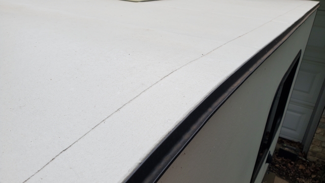

Postby philpom » Mon May 06, 2024 7:11 pm
A few others noted place the seam on top - out of site and a much better look. I did similar to the driver and passenger sides so no visible seams on those either.
My PMF has held up very for for the 3 or so years it's been outside.
A shadow is making this seam show more than it does in full sun, it's down tight. It also needs a bath :)
