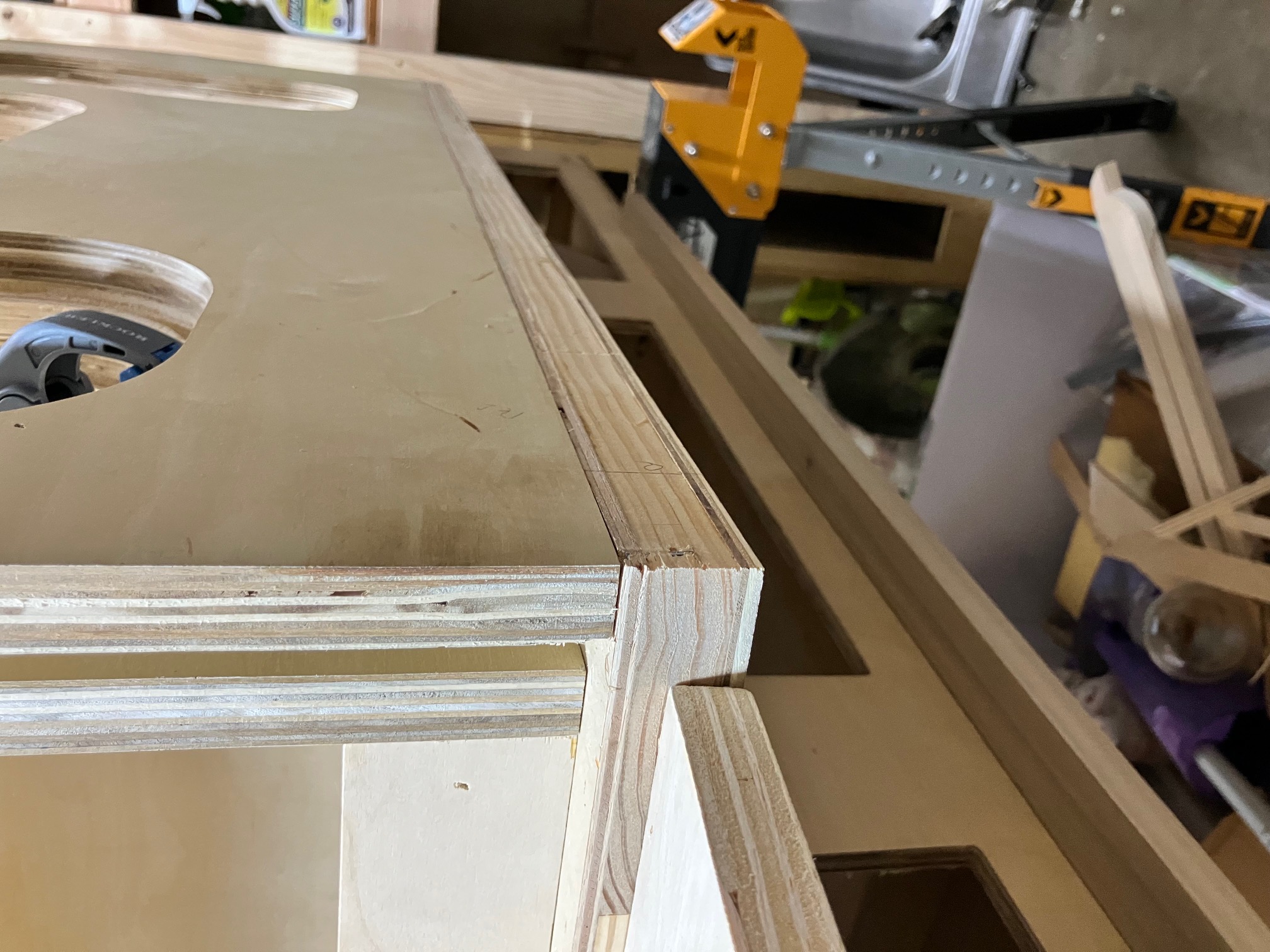

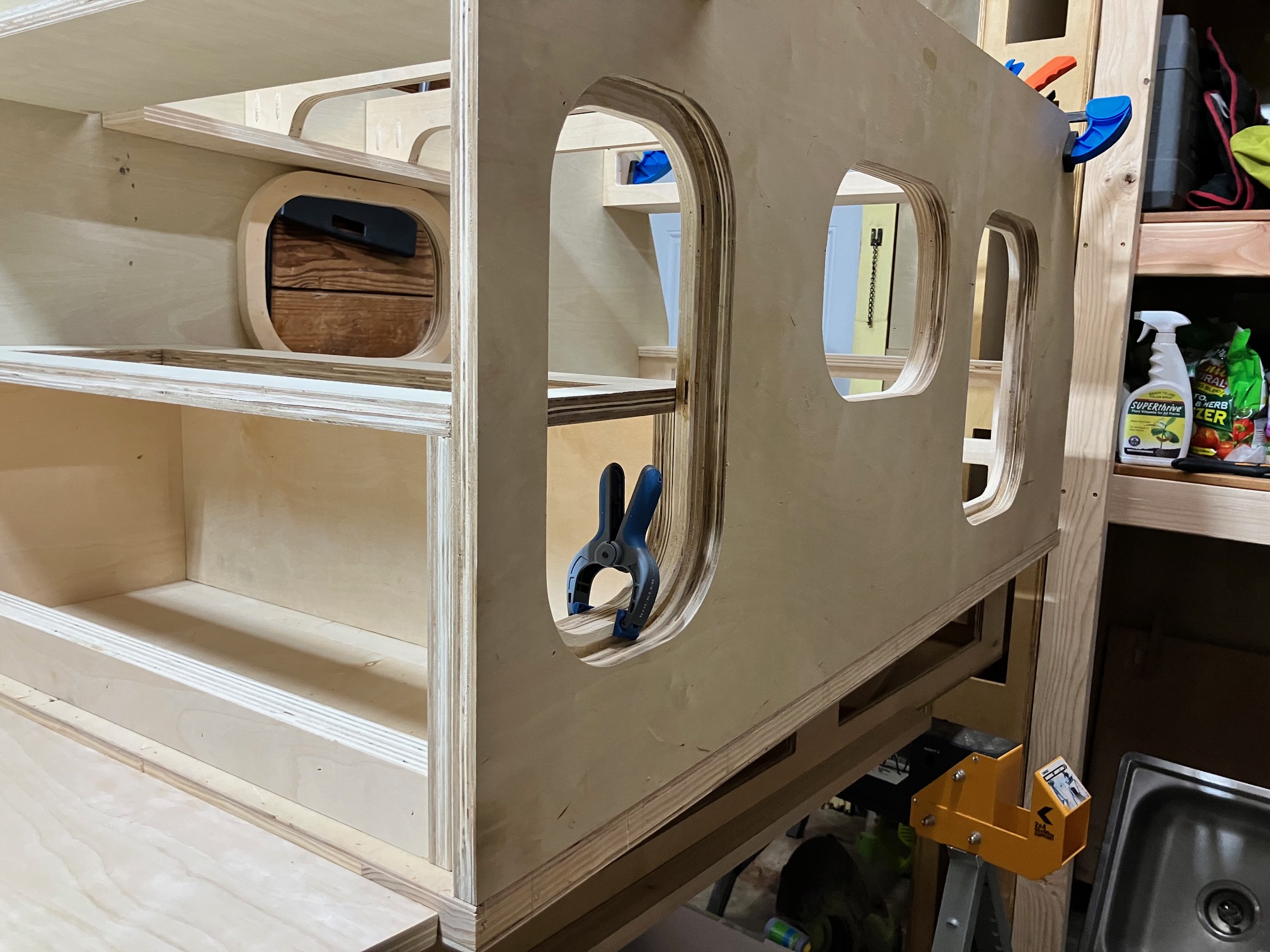

Started building a 1:2 scale model - trying to build it as close as possible to the full scale version as possible to get a better idea of how all the parts go together. About to start skinning it soon - going to do fiberglass+paint for sides - and then not sure what to do on the bottom.
Some options I've considered:
* Fiberglass and epoxy the bottom
* Only epoxy the bottom and then use biaxial tape (2"?) on the edge
*Fiberglass the sides, biaxial tape (2") around the edge (so 1" overlap), then paint or asphalt the center of the underbody
Progress pics:
