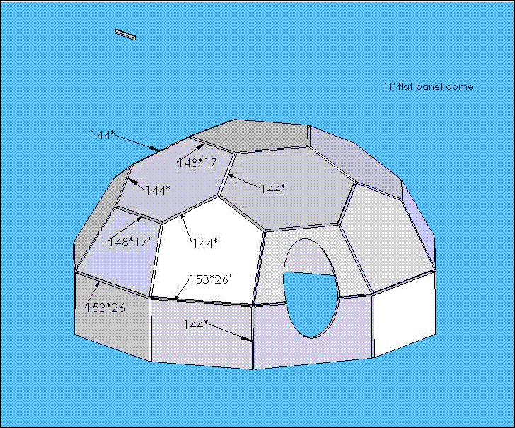

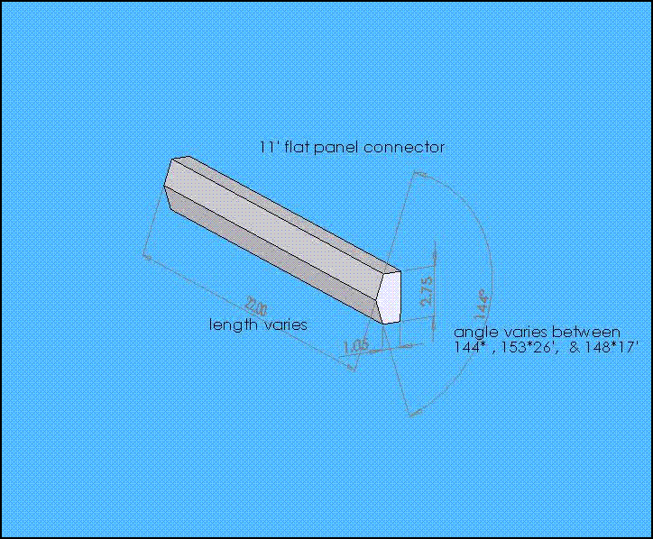

The following is a 11' diameter emergency shelter built from OSB used as an exterior sheathing, using ripped 2x4s as edge connectors. Total cost was less than $100.
The structure can be disassembled and stacked with a height of less than 18 inches, and a foot print of 4' x 4'.

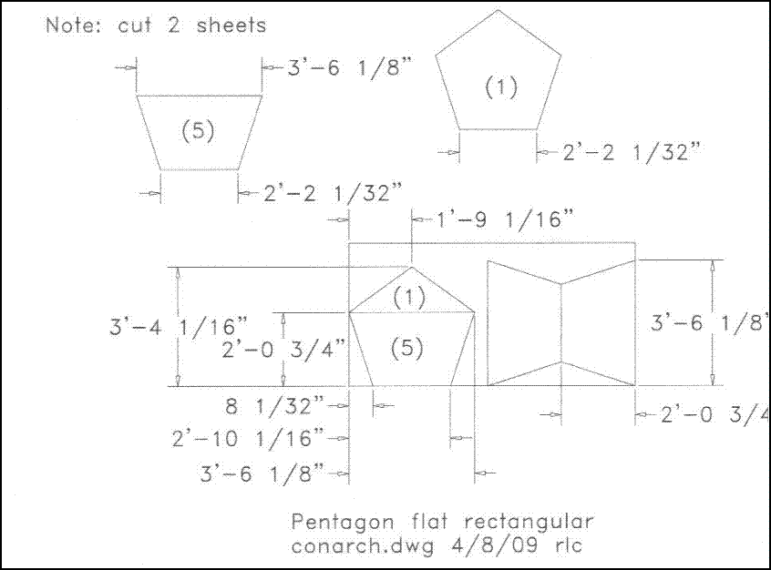

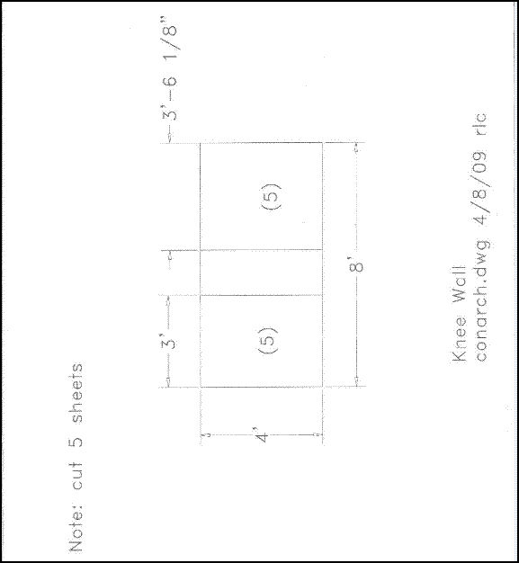

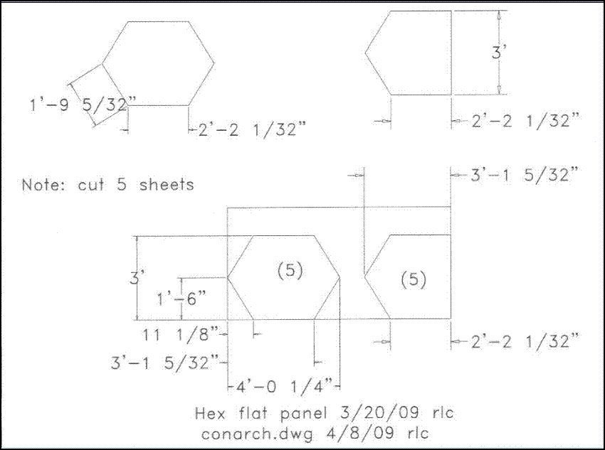

The cut list:

Re: 11 foot emergency dome shelter
Postby oakinteriors1 » Thu Nov 21, 2013 5:50 am
dome shelter 1.GIF (19.68 KiB) Viewed 6665 times
dome shelter 2.GIF (18.57 KiB) Viewed 6665 times
dome shelter 3.GIF (8.26 KiB) Viewed 6665 times
Postby oakinteriors1 » Thu Nov 21, 2013 5:52 am
dome shelter 4.GIF (34.87 KiB) Viewed 6665 times
dome shelter 5.GIF (46.1 KiB) Viewed 6665 times
Postby GerryS » Thu Nov 21, 2013 6:11 am
Math. It works!
