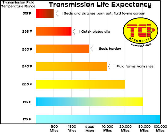

I have a factory tow package, transmission cooler and the manual schedule is fluid change at 100,000 miles but something I found:
I don't know what temp my idiot light comes on at but I'd rather know that temp so I can schedule an early change as I have hit 200 degrees several times and it makes me hold back even though I am cruising at 55.
