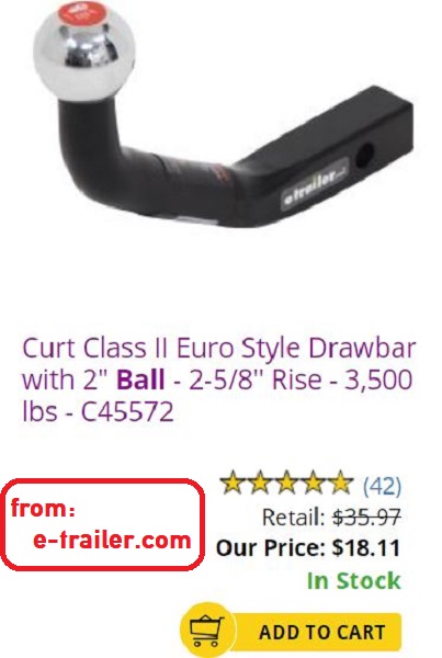

Or, alternatively, a European-style all-in-one, with the ball already on the drawbar...I think they look sorta cool on a small car https://www.etrailer.com/s.aspx?qry=European+Hitch+Ball&furl=-pg-Ball_Mounts
European-style drawbar for 1.25 inch receiver.JPG (58.82 KiB) Viewed 4793 times
173193172890148599
