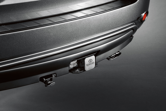

Toyota has a factory tow hitch for the Toyota Highlander (2014-2019) model year that is integrated into the bumper. You can just get it from the parts department and install it yourself. This is separate from their factory tow prep package which comes with larger radiator, bigger fans, engine oil cooler, and separate transmission cooler. The maximum towing capacity for the OEM tow hitch receiver is 5000lbs towing and 500lbs tongue weight. The payload capacity for the SUV is about 1400lbs depending on the trim level.
Here's the OEM version

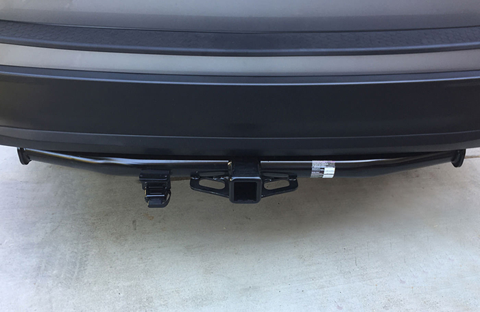

I opted for the aftermarket version which goes just under the rear bumper. At stock height, the Highlander has about 8" ground clearance with a departure angle of about 23 degrees . The tow hitch receiver brings it down to about 6" of clearance and probably less departure angle. It's still sitting higher than my mud guards. So far I haven't scrapped anything going up and down steep drive ways.... yet. My old Honda Odyssey would scrape EVERYTHING. But that has about 4.2" of ground clearance.

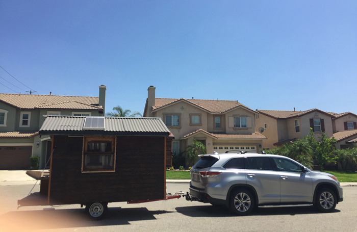

Here's a photo of my setup

cool i have considered the highlander but wish they were a bit smaller. love your tiny home!

It is a smaller 8-seater SUV. I would say it's about the size of a the 4Runner if you're familiar with that car. Speaking of that car, that's another one with a factory tow hitch receiver that is integrated into the bumper. While it's not completely in the bumper like the Highlander, it sits higher than the spare tire.
Thanks! We have about 3200 miles on it and we absolutely love it. People always come by to check it out when we camp.
