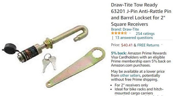

* There's an even rarer thing it might be...the entire receiver hitch assembly might be loose. Many receivers are bolted onto existing frames, using holes already on the frame. A nut is put inside the hole and the bolt fits thru the receiver structure and clamps the receiver assembly to the frame. If insufficiently tightened, the attached receiver assembly can come loose, allowing movement.
* I've had sevearal bolted-on receiver hitches over the years, and I check them for tightness every year. I normally use a weight distributing hitch that makes everything much tighter, also use a J-bolt anti-rattle pin to eliminate some slack. There's absolutely no slack in my set-up, now, and if I didn't see my trailer following behind me, I'd not even know it was there. Of course my pickup can tow 5 times the trailer's weight....
