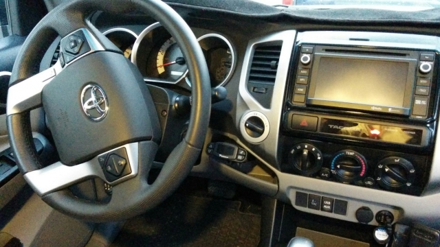

Here's where I mounted mine. The little cup holder was pretty useless so I didn't mind using the space for the P3.
I just replaced the sticky Velcro strip so we'll see how long this one lasts before it falls off again.
