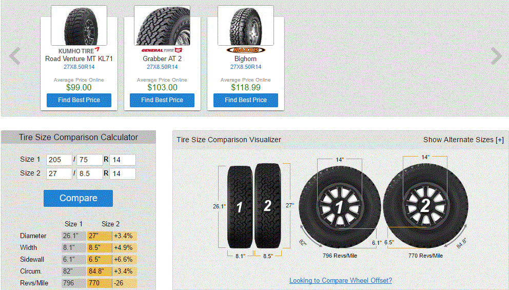

new vs old tires v.2.GIF (157.4 KiB) Viewed 10726 times
The ST tires had a load rating of 1760 lbs per tire- the LT tires have a load rating of 1520 lbs per tire; either tire is sufficient for my 1700 lb trailer. I don't feel the 1/2" tread depth (of the LT tire) will add to squirm or sway of the trailer; the flatter tread will grab the road better, and should give better traction than the thinner, shallower tread of even new ST tires. I've towed mainly tandem axle trailers, loaded weight from 2.5 tons to 5 tons...they are a different animal than the smaller single-axle trailer, and can followa slightly more lenient tire rule (within reason). Choose wisely!

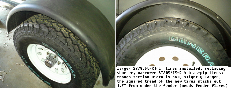

Postby working on it » Wed Mar 08, 2017 3:30 pm

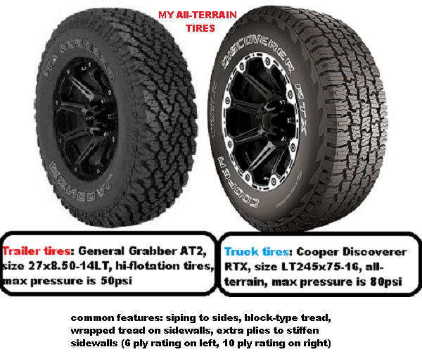

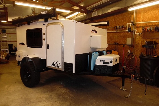

Finally got the AT2s on the trailer. They are heavier, and with noticeably more tread depth and width, though the section width is almost the same. The squared-off shoulder profile of the all-terrain tires does stick out an 1.5" from under the fenders. I will have to get extending fender flares to cover. Though I see lots of uncovered tires in Texas, and I could probably let it be, I will be going out of state, and also, I don't want to spray other vehicles. I might even use mud-flaps, too. I still have lots off fender clearance, similar to Tony Latham's trailer photo, so I'll be OK with mine.
    new tires & fender clearance.png (417.6 KiB) Viewed 10678 times
    Latham trailer fender clearance.jpg (76.56 KiB) Viewed 10678 times

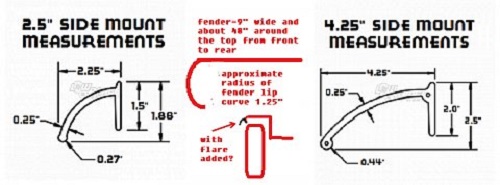

Re: All Terrain Tires/ tire coverage modification needed

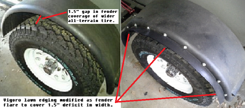

Postby working on it » Fri Mar 10, 2017 9:41 pm
working on it wrote:Finally got the AT2s on the trailer. They are heavier, and with noticeably more tread depth and width, though the section width is almost the same. The squared-off shoulder profile of the all-terrain tires does stick out an 1.5" from under the fenders. I will have to get extending fender flares to cover. Though I see lots of uncovered tires in Texas, and I could probably let it be, I will be going out of state, and also, I don't want to spray other vehicles. I might even use mud-flaps, too. I still have lots off fender clearance....
  • I said I could probably get by without complete fender over tire coverage in Texas, but I just can't do it, myself. I've been trying to find the ideal fender flare for my rounded-lip fenders, but of the two candidates, both by Pacer Performance, I just couldn't see either working out 100%. One goes under the lip, but being rounded, the fender lip would tend to angle the flare downwards; the other, meant to attach to a vertical surface, would also not completely fit the rounded fender lip. I did a lot of research, and couldn't decide. Note: the fender is so solidly mounted, that I didn't want to do it again, so removal of the fender, and modification or reshaping the rounded lip, were not to be considered.
  • So, I tried an old trick, using a re-purposed rubber strip or conveyor belting fragment to cover the tires. But, this time, I used Vigoro lawn edging, since I needed something with angles or rounded surfaces I could experiment with, to find the best fit of the rounded lip. I decided to go with the natural curve of the rolled edging (wrinkled badly when trying to make it go the other way). The stiff oval outer edge almost fit inside the fender lip radius perfectly (with fingertip pressure applied), so I hand-fitted the edging into the fender lip, worked with continuous pressure all around the fender, to get the exact length I needed to cut to length. When that was done, I looked down to see the tire coverage I wanted, and marked it with a soapstone pencil.
  • Back at my truck tailgate (I use it for projects, since my garage is full: trailer & parts in one bay, my Chevelle dragcar, parts, and assorted equipment in a second bay, furniture from two rooms being re-built in the third bay; I haven't been able to use my workbenches for three years), I saw a thin line marked on the edging that was exactly where I marked it. That made cutting the edging much easier; I followed the line with kitchen shears. I tried to get the trimmed Vigoro to stay in the fender groove, so I could take pictures and decide if it was OK enough to use on my rough-hewn trailer, but with tape and clamps in various positions, it would not stay where I put it. So, not wanting to do this, I went ahead, marked equally-spaced spots along the fender edge, and started to drill pilot holes (at a consistent angle), to finish with the self-drilling Tek screws. After having three bits snap, when the rounded fender edge caused them to slip out of the indentations I provided, I tried to make the holes of uniform angle and placement, but they ended up-not so much.
  • Anyway, the 3/4" long Teks (with a washer underneath) were just long enough to grab the plastic oval edge under the lip. It would never hold the edging in place on the road, but it was good enough for photos. If I decide to keep it, I'll taper the leading edge, attach 12-inch wide mud-flaps at the rear (bolted to both fender and plastic flare, for continuity), and re-attach all with #10-32 (probably 3/4" long, again) button-head cap screws (with washers on only the underside of the plastic), and nylocks to secure. I don't think it looks too out of place with my handyman's approach to trailering; others, with a finer aesthetic taste may think them "ghetto", but at my age, I don't care...just if it works.
  • I'll wait a week, or so, see if I still think it's OK, then either remove it, or duplicate it on the other side (with hardware changes). But, after drilling the holes in the fender, I'm committed. I could probably use the same holes with the Flexy Flares, so that is now a back-up plan.
    before & after flare install.png (422.6 KiB) Viewed 10601 times

Postby working on it » Sun Mar 19, 2017 11:36 am
  • Well, I only waited four days, and bought some #10-32 x 1" capscrews. black oxide flatwashers, and some #10-32 nylocks. I removed the Tek screws from the fender, one at a time, drilled the fender and lawn edging with a 3/16" bit (using the same holes that the TEKs had made, this time making sure the angle was more consistent). Previously, the Teks were only partially penetrating the hard oval edge of the Vigoro, so they would've worked loose at highway speeds. I drilled all the way thru the oval edge, so I could put a washer and nylock to ensure them staying put. I had trouble getting the capscrew to go all the way thru enough to get the washer/nylock onto the end, to tighten. When I succeeded, using a lot of force to coerce the oval to fit into the curved fender edge, and tightened the screws, then the Vigoro wrinkled up badly. Looks like ruffles on a petticoat (I'm old, I remember girls wearing them). I went ahead, doing the same procedure on the other fender. Same result.
  • I don't know if releasing some tension from the tight fasteners would also remove the wrinkles from the edging (I ordered some 1.25" long capscrews to use, perhaps the extra length will make a difference. If that doesn't work, I'll try using a hair-dryer to attempt reshaping them.I tried both of the above methods to smooth out the wrinkles (or ruffles? another term for disorder, it describes it better), and neither worked. Releasing tension by backing off on the bolts did nothing- the ruffles were already set; using a heat gun (first on a scrap test piece) just deepens the color, and actually emphasized/increased the waviness. I left them alone after that.
  • So, I went on to phase two: I took some very stiff 12" wide conveyor belt material (the same stuff I used for my hatch gap covering), and cut off two 12"x12" pieces, then used galvanized 1"x12"x1/8" thick bar stock to clamp them on a brace at the rear of each fender, before I drilled and bolted them there. I broke two more bits, hitting inner welds, and stripped the bolt holes on three of six bolt holes, so some Tek screws were used to supply a more secure attachment to the fender brace on both sides. I'll use bigger/better hardware later on, but I'm rushing to complete several trailer upgrades in a month's time. The mud flaps are at a 45 degree swept back angle, taking over where the fender flares leave off, to divert tire ejecta. Finished after dark, an didn't have my phone/camera with me to snap photos with, but I'll add them tomorrow. I like to re-purpose material for other uses. Half-just being cheap, and half-just being different. That's always been the way I do things. I re-purposed conveyor belting as mudflaps, yesterday, just as I had used it before as a cover over the gap between my trailer body and opened rear hatch (I had snatched it from the scrap barrel at work, just with that use in mind).
  • I still wasn't satisfied with the wrinkled, ruffled look of the re-purposed lawn edging I used for fender flares, and saw no way to avoid removing them and finding another solution. I liked the solid way I got them to fit, and I'm sure they would've worked well, but they just bothered me. So, after contemplating using rubber tire tubes to cover and smooth-out the wrinkles, I suddenly had an epiphany, to use the same conveyor material to do the job.
  • I still had my drill ready with the correct bit, and the impact still had the right bit in it, so I cut 2" wide strips of material (with my cut-off wheel), and used the last of my #10-32 x 1" capscrews, washers, and nylocks I had bought for the fender flare job, and bolted the conveyor belt to the lawn edging.
  • Now, the edging acts as a supporting structure, and the belting presents a horizontal, smoother appearance, around the fender curve. You can still see the wrinkled edging, if you view it on edge, but that's just part of the design (I'll claim, haha). The conveyor belting matches my grey trailer color scheme, now used for three functions. Yup, just as I planned all along. As a old dragracer, I learned a long time ago that if you change just one thing on your racecar, then very often, you'll have to change three or four other things...I find that this is true for trailer building/modification, as well. It may just be me....
  • 147398 TEK screws to be replaced with bolts
  • 147399 flares wrinkled up when tightly secured
  • 147400 capscrews look good, wrinkled fender flares do not
  • 147401 added conveyor belt mudflaps
  • 147402 then added matching conveyor belt material to cover the wrinkles!

  • Sidewall stiffness is a concern for me, anyway, because I drive fast and corner fast. I've noticed sidewall flex in ST tires that were under-inflated, and in my truck's LT tires, as well. Once, I went to a Discount Tire near work, to get my tires rotated, while I went to lunch (a rare treat at work). When I retrieved the truck, I saw that they did rotate the tires (I marked them), and went back to work. After work, driving home, I made a lane change on a long, fast, curve, and the truck went wonky on me. I pulled over and looked at the tires, and checked the pressure on each. The front tires had 75 psi, and the rear had 45 psi. They had rotated front to back, not changing the tire pressure (I run 45 in front and 75 rear, because I'm always carrying heavy loads at any time - door sticker recommends 50 front , 80 rear).
  • What happened while driving was that the rear tires weren't firm enough to handle the weight shift, the sidewalls flexed when I wasn't prepared for it. I took my inflator out, inflated the rear tires to normal, and the fronts were deflated to normal, and I went back to the long curve to repeat the maneuver. Drove perfectly this time. My TTT is on the heavy end of the TD weight scale, and I always had the recommended tire pressure in the bias-ply ST tires, to maintain stiff sidewalls with less heat buil-up. Now, with LT (radial) tires on it, I'll start with the recommended tire pressure, and reduce it if I see any uneven wear, or excess bounce. The LT tires can accommodate lower pressure than the bias-ply ST's, having more flexible sidewalls.
  • As to trusting Chinese tires, I'm sure some are better than others, but who can tell which ones? I've read many horror stories of Goodyear Marathons, after they started being made in China, for instance. That's exactly why I chose LT tires over ST tires this time...I couldn't find any ST tires with the tread type I wanted, nor the guarantee of being made as well as the Carlisle and Denman ST tires I trusted for many years (both made in the USA). I've not had much luck with the Chinese radial ST tires (the bias-ply last longer).

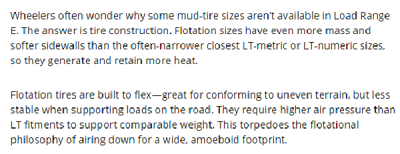

  • I have a little more information to add to the thread. While favoring name-brand LT tires over no-name or Chinese-made ST tires for my trailer, I have to mention the differences in two LT tire types: LT-metric (example: LT245/75R16 - my truck tire) and flotation (example: 27/8.50R14LT- my trailer tire). I needed 14 inch tires for my trailer, and the only ones available I could find, were both the flotation type. I chose the one that had the more all-terrain type tread over the more mud-bogger style, for the mostly highway use it will have.
  • I acknowledged that the ST tires, as a rule, have stiffer sidewalls than LT tires, I failed to note that the LT-metrics have stiffer sidewalls than the LT-flotations, while the flotations are wider and have more heat-generating mass than the metrics. Both factors mitigate the advantages I saw in getting LT tires to replace my aged ST tires, on the highway, but the added tread depth, flotation on loose surfaces, and extra beefing around the bead all add-up in their favor for limited off-roading. I find it to be a workable solution that many people have tested before me.
  • differences between LT-metric and LT-flotation tires-Fourwheeler network.PNG
    differences between LT-metric and LT-flotation tires-Fourwheeler network.PNG (58.73 KiB) Viewed 10434 times
  • The complete article can be found here:http://www.fourwheeler.com/how-to/wheels-tires/1407-understanding-tire-load-ratings/

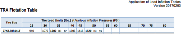

  • I was looking into adjusting the tire pressure downward from the max. inflation stamped on the tire (50 psi), following threads here on TnTTT and on Exploration Portal, among other forums, and found a chart from Toyo Tires https://toyotires-1524598101.netdna-ssl.com/media/2125/application_of_load_inflation_tables_20170203.pdf that I was considering following. It takes into account the construction differences in the LT tires (and many other types) and shows recommended pressures for each. It's up to the user to determine how closely to follow the recommendations (I always choose higher pressures, due to my aggressive driving style). here's a snip of the LT chart, for my tire size:
    tire inflation vs loading from Toyo tires.PNG (40.77 KiB) Viewed 10434 times
  • Since my 1700-1800 lb trailer(say 1850, to be safe, it's an estimate) has a load of 925 lbs per tire, I see that I could deflate down from 50 psi to 25 psi. !!!! I really have doubts about this on the highway, slinging my trailer around, dodging potholes and 18-wheelers. I would prefer, first time out on a road trip with these new tires, to start at the max pressure (cold) of 50 psi, and use my experience to judge how close to the 25 psi that I would dare go. If I was off-roading even, I probably wouldn't go to 25 psi, always preferring 20% more than minimum, when the tires are mounted on narrow wheels (mine are 6", making the sidewalls have more flex than a wider rim). It's a work in progress, but at least I have more info to base future decisions on.
  • The attachment tire inflation vs loading from Toyo tires.PNG is no longer available
Another check you can do is the "chalk test" with the trailer loaded color a straight line accross the tread with chalk, then drive straight ahead for a little bit. If the chalk wears off in the middle, then the tire is over inflated, if it wears off on the edges, then its under inflated.
This is a table I found a while back, its based on the load rating of the tire
tire load vs psi.jpg (296.78 KiB) Viewed 10422 times
A lower pressure will also help the trailer ride a bit smoother, and make it less likely to catch air on the bumps.

  • I saw that video awhile back; it confirmed my choice of all-terrain tires for both my truck and later, my trailer, were the best compromise for me. I might never need any mud-terrain tires on my trailer, since I haven't made it off-road yet, but for the little dirt or gravelly road travel I foresee (until I have a 4wd vehicle), all-terrain will do the job, on each.
  • I carry heavy loads in my truck, and since it came with E-range LT tires on it, I would not consider anything of lesser strength. I chose the best tires for the money, but with a more aggressive tread than others, for the occasional unpaved road. I might've chosen the same tire for my trailer, but could only find just a few 14-inch LT tires on the market, and bought a moderately aggressive tread pattern tire, for the same reason (my other choice was a true mud-terrain tread, but felt that it was not needed-yet-).
    MY ALL TERRAIN TIRES.png (272.3 KiB) Viewed 10256 times
    similar open tread and siping for all purposes

on my squaredrop I run 235x75Rx15 General Grabbers ATX 10 ply. I like a stiff side wall on my trailer for many reasons: tire stability, more control on & offroad conditions.
forum (8).jpg (99.2 KiB) Viewed 7757 times
