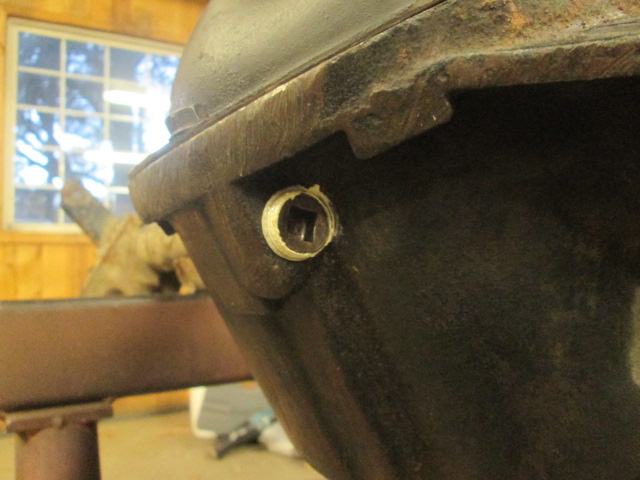

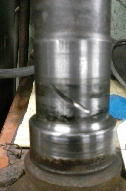

Imagine my subtle disappointment last night when I pressed the axle bearings off and found this mess lurking under the left side race.
Some prior monkey had used a cutoff wheel to cut a previous bearing race off of the axle shaft and gouged whole hog into the shaft. Rookie mistake.
Two schools of thought: (1) the PO was wheeling 35 inch tires and didn't break it, he broke the spider gears instead, so go ahead and run it (two of my mechanically minded coworkers were fine with this approach) and (2) if it does break the fact that it is a non-C-clip style axle really will not make a difference; it will break right in the axle bearing and the wheel would most likely part ways with the vehicle; do it once, do it right, you're in this deep already. I found a replacement listing on Amazon for $153 w/free shipping, so I think I am going that way, but it could take a week to get here. :NC

Its already apart. I would replace it.

I wouldn't worry about the cut weakening your axle,that is not where it would brake ,they twist off the splined end when they fail. U-TURN.

Thanks guys. I too have mixed thoughts on replacing the axle, but have ordered (what I hope is correct) the axle from an e-bay dealer; an Omix-ada stock replacement. There was a great deal of confusion on my part due to the way they are listed. Most postings show the axle with wheel studs, retainer plates, seals and bearings, however, there is a large cost difference between the assembly and the bare axle shaft. There also is a big difference in listings for Rubicons and non-Rubicons. Some suppliers list separately for TJ’s and Wranglers, which is just dumb because all 2003 (my year Jeep) and 2004 (the reputed year for the axle assembly) of this type are both Wranglers and TJ’s; the model differences are Sport, X, Unlimited (long wheel base), and Rubicon (or some variation thereof). Essentially what we think of as a traditional military bred style of jeep is a Wrangler, and all models from 1997 to 2006 are TJ’s (coil sprung pre-JK). At least that is how I understand it.

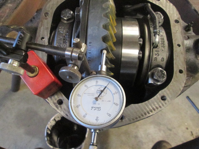

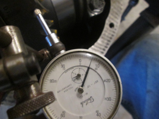

I decided to leave that be for now and do an initial check of the carrier; mostly to see if I was on track w/o the ring gear spacer. So in went the carrier with no shims. I got a consistent 0.152 inch thrust into the pinion. I could make it go more, but sensed that the carrier was starting to ride up on the pinion, lifting the opposite side race out of the saddle. Since I could get this to repeat, and could pretty much tell where the carrier started to ride up, I figured that was good for an initial check w/o installing the bearing caps. This was good news, in that it confirmed that the gear spacer would not be needed.
I measured the original shims again, this time using a 0-1 inch micrometer, and found that they were each .001 inch more than I had measured with the calipers. So .131 inch on the gear side and .141 on the opposite side. So if I swapped the .141 shim to the gear side and add a .011 shim from the kit I would get the recommended gear side preload (i.e. zero initial clearance; .141 + .011 = .152).
From before, the total thrust (less preload) was .258, so that means that the prior preload was actually about 0.014 inch (closer to the spec .015; .131 + .141 = .272; .272 - .258 = .014).
So if we subtract the .152 from the measured .258 total we get a .106 remainder on the opposite side (for zero preload). Add in the .015 desired preload and we are looking for a shim pack of .121.
In theory this preload spreads the housing equally, so we should get about .0075 clearance with the pinion after the carrier is forced down between the shims.
Not having a case spreader, not wanting to have to make one, and having read that you can force it by using a dead blow mallet, I decided to try it even though they recommend using the zero preload settings for setup.
Well, unlike the single individual shims that came out of the 5.13 gear setup, the shims included in the setup kit packs turned out to not be hardened; some were even galvanneal plated. We managed to put a pretty good gouge in one of them trying to get the carrier to tap in. Not only that, but they were also not the full dimension. Compared to the good hard steel shims they were more open on their ID, so would have less bearing surface under the cup race. Not sure how much, but I know that Timken specifies a minimum bearing support diameter; in other words, you have to adequately support the back of the cup and can’t just cheap out on these shims. I guess they weren’t any less than the area backed by the casting on the outer side of the saddles (which have a narrower land than adjacent to the saddles), but they just don’t seem to have the same quality as the larger hardened steel shims.
We figured we could get it to go, eventually, but decided to stop and work on the setup with zero preload.
The thinnest shim in the kit was about .005-.006, then .010-.011, then .015-.016, a couple at .025-.026, and two at .099-.100.
Attempting to set zero preload while splitting the difference in lash clearance, I backed off on the gear side shim to .141 + .005 for .146, and backed off on the opposite side to .099 + .011 for .110. This would still be about .004 preload, and was as close as I could get to balanced with the available shims w/o resorting to stacking a bunch of thinner ones (wanting to keep the thickest shim possible up against the bearing cups to avoid damaging them when “dropping” the carrier in).
The carrier went in much easier, but with some tapping. However, it was pretty clear that there was no lash or wink between the ring and pinion. The ring gear was tight and could not be easily turned, while the pinion could be turned but felt “notchy” in doing so. We decided that it couldn’t hurt to do an initial read with the marking compound to confirm what we suspected was a high pinion; and it was. The pattern on the drive side was running off the toe (inside diameter of ring gear) with the tell-tale wedge shape biased toward the flank (valley), while the coast side looked to be well centered between flank and face (tip of gear), but was also biased toward the toe.

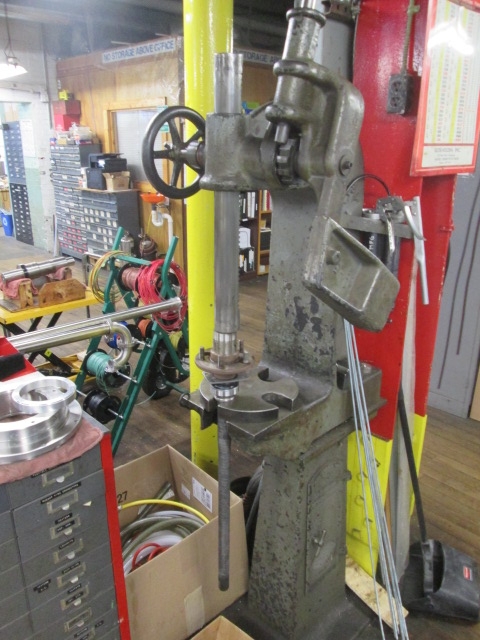

To remove the old axle bearings I used a bearing splitter (like this)…
… to pinch in under the outside edge of the inner race, then set that up in the hydraulic press, because the bed on that press can be adjusted way down close to the floor to fit something as long as an axle. I much prefer using the arbor press whenever possible because it gives you a much better idea of how much effort you are using. There is no pressure gauge on the hydraulic press so it can be a bit more unforgiving; pump ‘til something moves, and if it doesn’t move easy it usually goes “bang”… loudly. If you’re lucky it goes bang and moves. If you are unlucky it goes bang and something breaks.
This time no troubles; just a few pumps, a small bang, and the bearings drifted right off.

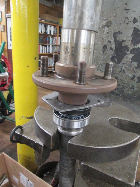

Going back together, the other way, the setup fit in the arbor press just fine; so that’s what I used.
Here you can see the press plate on the bottom (with various size openings); an old bearing race that was kicking around the press that fit loose over the axle but was very close in size to the new inner race; the new bearing already packed with grease; the axle seal slid up out of the way, also holding the drum brake style retainer plate out of the way; another slug of metal to span across the dished out area of the spigot where the wheel aligns; and the shaft of the press above that.

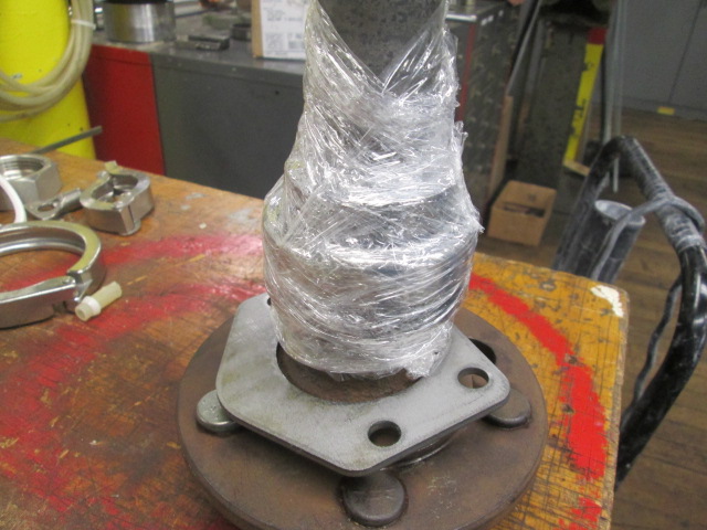

Although I made sure that the old race used as a push tool fit easily over the axle (so as not to accidentally press it onto the axle), and it looked like the slot in the press plate was plenty big enough, the later turned out not to be true. The taper of the shaft pinched in the press plate just enough that I had to tamp the end of the axle on the wooden floor to pop it free from the plate again. Fortunately there were no gouges or marks, and the bearing was well seated. I used a little different setup for the retainer ring that gets pressed inside of the bearing (not shown). The next size slot in the wheel plate was too big for the spacer, so I used two big rectangular steel plates on edge under the spacer race to push the retaining collar on.
I wrapped the bearing in stretch wrap to keep it clean in the meantime.

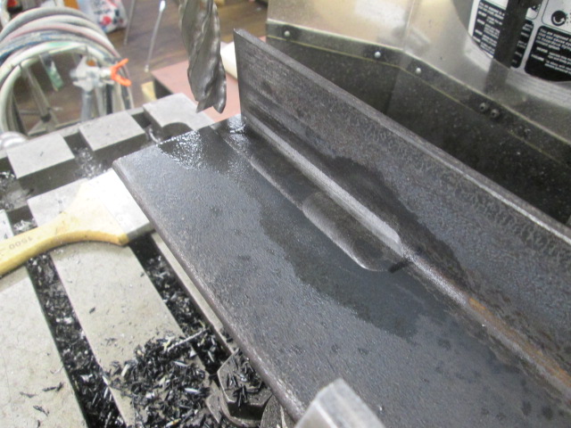

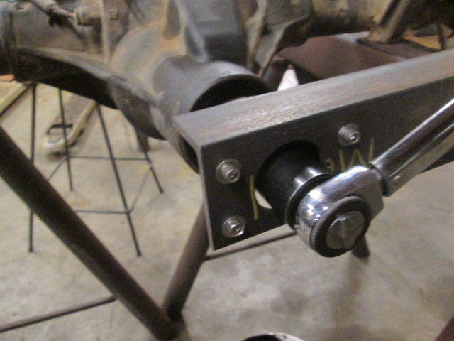

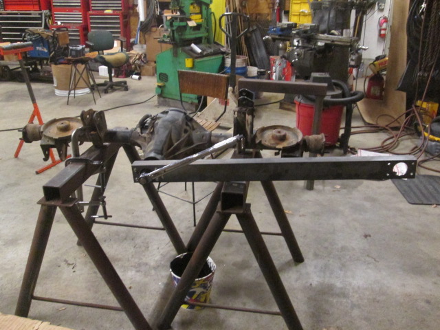

For the big wrench needed to hold the pinion yoke while torqueing the pinion nut to 225-250 lbs-ft, the old 1310 yoke that I’ll be using for setup has a slight taper between its shoulders and the land where the U-joint straps seat; so it can be seated up against the vertical leg of the angle and still clear the radius on the inside. However, the new 1330 yoke is much blockier, with straight shoulders, so in order have it be supported by the outer leg of the angle I had to mill a portion of the inside radius away.
Then I transferred the holes, drilled them and hole sawed the clearance hole for the socket wrench.

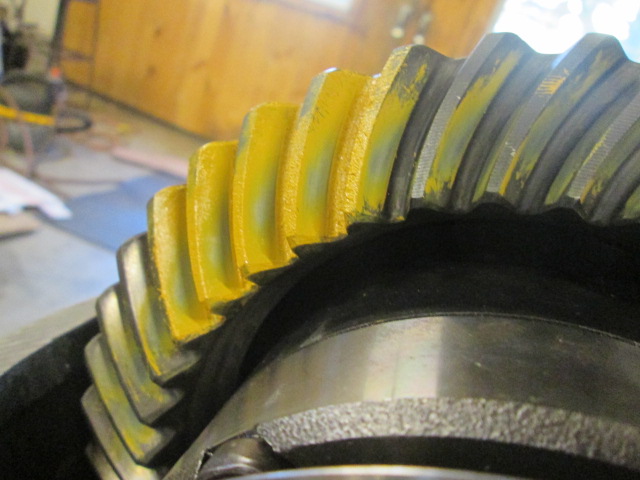

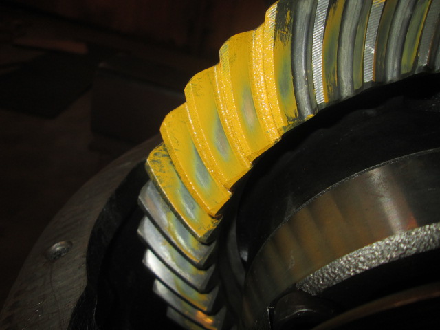

I figured it couldn’t hurt to mark the gears and check for a pattern. This one wasn’t as easy to read as the first one, but it seemed to suggest that the pinion was still too high.
So I plan on taking another .003 - .005 off of the pinion depth shim.
I’m struggling a little to understand the manual instructions, since they say to set the gear side carrier shim for zero clearance with the pinion, and then wedge all of the preload onto the opposite side; or leave out the preload amount for setup. The issue I see is if you leave out the preload for setup, you still won’t have any backlash unless you take shim away from the gear side to simulate the shift that will happen when you put the preload shim in. So, as mentioned previously, I am leaving about half of the preload amount out from gear side and only adding about .004 of the preload amount on the opposite side (mostly because that is what is convenient with the shim thicknesses that I have).
Taking that much out of the pinion depth shim doesn’t make much sense if you just look at the pinion markings, but the marking compound has the last word.
Next time I’ll do it all again with the thinner depth shim, even less pinion preload shims, and will probably start snugging the carrier bearing caps down while checking.

The other thing they suggest doing differently, or at least explain better, is using the carrier shims to get the correct backlash at zero carrier bearing preload, before attempting to add preload shims equally to both sides (as opposed to setting the ring gear tight to the pinion, getting no backlash, and then compensating by putting all of the preload shim to the opposite side. I kind of already had that figured out, and it didn’t help that I must have mixed up the thinner of the carrier shims (each side currently consisting of one thicker and one thinner shim), but it just didn’t make sense that I had lowered the pinion even further and seemed to have lost backlash instead of gained.
Well, once I readjusted the carrier bearing shims again, I managed to get it to a happy place with zero preload, verified no side-to-side thrust slop, and had about .005 backlash (the minimum acceptable value). Now I can fine tune that by biasing how much preload I add to either side, and hopefully it won’t be affected too badly as I get the pinion depth dialed in.
Speaking of pinion depth, I ran the pattern and, if I'm reading it correctly, it now says that the pinion is too deep, so I need to source new shims (or go to the under cup shims that I just don't want to use.)

Again, I’m sorry that I’m not taking more pictures of the dial indicator setups, marking compound patterns, literally each step… I will try to do better… but this job really just needs to get done and it takes a surprising amount of concentration to keep moving in a positive direction w/o stopping to take pictures. I can’t imagine how anyone would even attempt to do this under a vehicle. When it comes time to do the front axle I will either pull the existing assembly out, or buy another axle to setup and swap in.

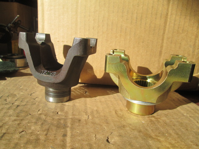

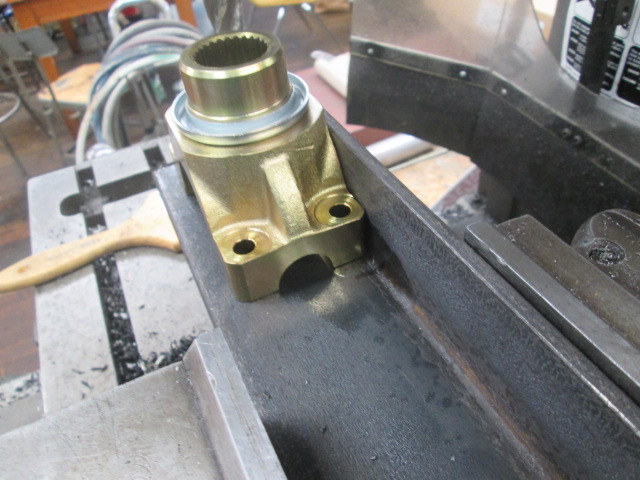

It occurs to me that I haven't mentioned that the new 1330 pinion yoke is about an inch shorter than the 1310 yoke. So that might solve the driveshaft length issue, save a few bucks by not having to modify it, and make the decision for me to run the hybrid 1320/1330 U-joint.

Found a Spicer 1310/1330 crossover U-joint, PN 5-134X (Moog 353) in stock at my local NAPA store (NAPA know how, go Ron Capps!). Will be picking that up after work today.

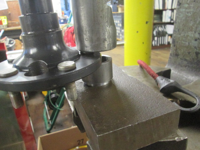

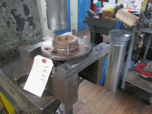

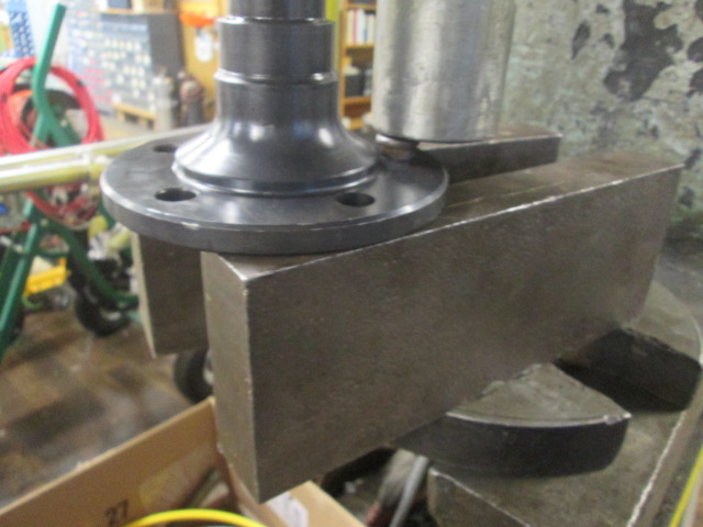

Last night I pressed the wheel studs out of the damaged axle using this setup in the arbor press. The trick was to keep the flange supported well, and flat, as close to the stud that was being press as possible. Not as easy as it sounds with the long axle shaft sticking down; had to cantilever the big press plates off the edge of the table.
Close inspection found the studs to be suitable for reuse, so I pressed them right back into the new axle. The first one wasn’t so hard, since I had all of the flange to work with; but the axle shaft barely cleared the head of the press with the arbor just covering the stud head.
Once I had the first stud in I realized it and the rest would prevent this same setup, so I found a round spool piece whose wall thickness fit between the stud and the wheel hub. I had to make sure that the arbor didn’t come down on the flared step on the back side of the wheel flange.
With the clutch on the press not working well, I practically needed 3 hands to hold the axle shaft up, get the arbor down onto the stud, and then switch over to using both hands to put most of my weight hanging on the lever to drive them in (about 6k lbs force). Then I had to be sure to not let tension fully off until I had a hand on the axle to keep it from falling when I let up. Felt like juggling a 30 lb. dumbbell.

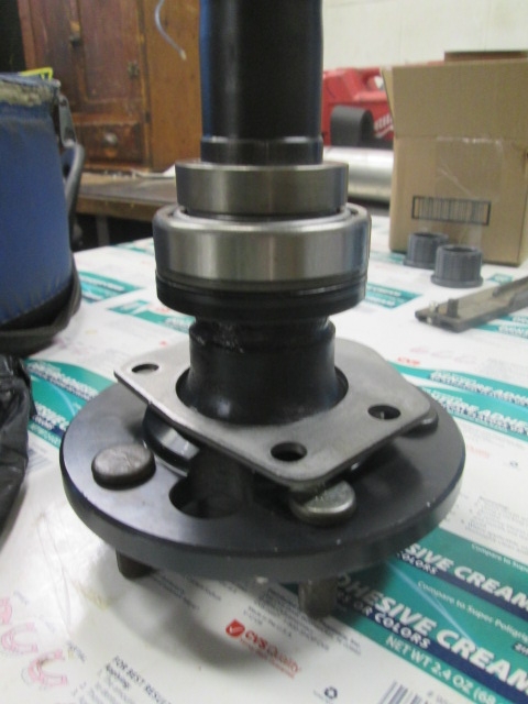

Next up was assembling the wheel bearing set. First the drum brake style retainer plate; then a little wheel bearing grease on the seal lip and mating surface; the seal; press the bearing; and press the bearing retainer ring.

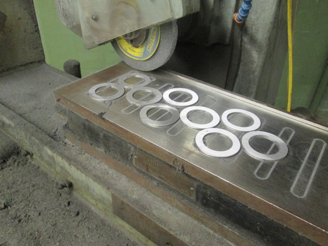

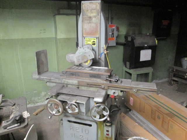

Grinding the inner pinion bearing shims.
I had hoped to fit enough on the table to get .0015 increments from .062 down to .047, but the magnet wasn’t as strong to the sides and they wanted to roll out from under the stone if I tried to make any kind of time roughing them down. So the loose ones got peeled out and I prioritized grinding .0585 thru .050 or so (plus the .046 shim from before; .0545 was installed when pic was taken).
Once I had them all down to .062 it just took a few more passes until I could peel one off, closing up the needed table travel and gradually speeding the process up as I peeled each successive one off. It still took a surprisingly long time, and once I had it setup I didn’t want to stop until it was done, so I didn’t get home to dinner until about 9:30 last night.
Now that I had the backlash situation opening up, I had a feeling that I needed to be headed back in the thicker direction on the pinion depth shim; so today I did three (3) successive fittings moving back up thru .0545, .0565, and .0585 thick shims.
But wait, you say, that’s thicker than when I was getting readings saying that the pinion was too close. Yes I say, but that was with inadequate backlash. The other thing I learned was that it helps not to be timid and just start right off following the instructions. The Yukon Gear instructions say to run the marking compound past the pinion 4 or 5 times before attempting to read the pattern, and, for used gears, to concentrate on the coast side of the tooth. The multiple turns didn’t really change the pattern, but it did make it much clearer and easier to read.
All the time I’m doing this I was also adding pinion bearing preload shim back in. By taking the time to put a little more torque on the pinion nut I could start to get a better feel for the running torque preload, eventually getting up to 150 lbs-ft on the nut with about 20 lbs-inch drag registering on the dial wrench while turning it free. Here’s the yoke wrench I made.

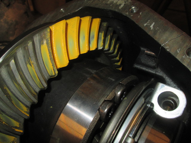

All the while the gear pattern kept improving. So I went back into work and ground four more shims in .0005 increments, covering .059 thru .0605. Remember that etching on the pinion? It was -.5
Now I started to wonder if the .042 baseline listed in the Yukon Gear instructions was more of a conservative starting point than an actual OEM standard zero reference. So I jumped right up to the .0605 shim and pulled another .006 out of the gear side carrier shim (the backlash had crept down to about .003 with the .0585 depth shim). That did it. The backlash was finally in the middle of the spec and the pattern looked about as good as I could expect it to get. Here’s a shot of the drive side pattern.
And here is the coast side.
So I’m happy with that. So out comes the inner pinion setup bearing. Tomorrow I’ll press the real/new bearing on.

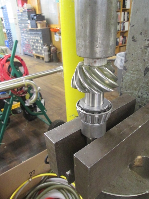

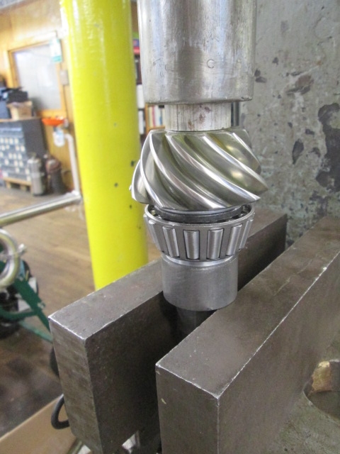

I started out at work this morning using the arbor press to install the actual inner pinion bearing (the new cone instead of the setup one). Here you can see the press setup with that same tubular piece I used to press the wheel studs being the perfect size spacer to push on the face of the inner race without interfering with the roller cage or pinching on the pinion shaft. That’s resting on the big press plates with the threaded end of the pinion sticking down in one of the slots in the main press plate. Above the spacer is the bearing cone with the .0605 thick depth shim sitting on top. On top of the gear is an aluminum puck to protect the surface from the arbor.
It was a moderately easy press, just like it was supposed to be.

Back at the shop getting ready to install the pinion; here’s a comparison of the original Rubicon spec pinion yoke (plain steel w/ rust patina) and the Yukon Gear replacement (yellow zinc chromate). Hopefully the shorter yoke will compensate for the longer snout on the D44 and will preclude having to have the drive shaft shortened; if so, a lucky accident. I could feel a little hint of the tool pattern on the seal mating surface, so before installing it I wrapped a greenie pad on it and polished it just a tad. You can also see the worn area where the seal had been riding on the old yoke.

Now I don’t have a torque wrench that goes to 200-225 lbs-ft. But torque is just force by distance. So I measured Karl’s big breaker bar; 15 inches from center of drive lug to center of handle; did a little ratio math (15 inches = 1.25 ft and 225 lbs-ft / 1.25 ft = 180 lbs); then, making sure that the handle of the wrench was parallel to the ground during coming up on final, I stood on my bathroom scale and pushed down until I lost 180 lbs. Good enough and far more accurate than guessing with an impact gun.

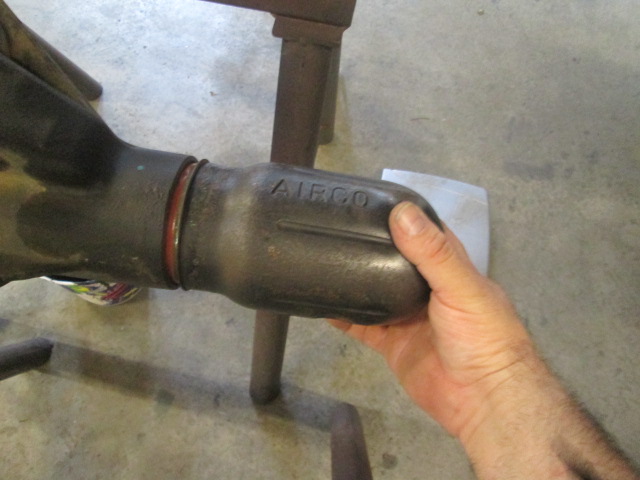

After that I removed the used nut and drove the yoke seal in using the cap off of a high pressure gas bottle as a driver tool. The seal shell comes with a bead of rubberized material on its OD to seal it to the housing bore, but it seems to be common practice to add some gasket sealant, too. So I stopped short of driving the seal flush and ran a bead of silicon under the flange; then drove it the rest of the way and wiped up the excess. Here’s the driver arrangement.
With the seal installed, its lip greased, some gear oil smeared on the sealing surface of the yoke, the washer faces and the face of the new nut, I put a dab of red Loctite on the pinion threads and did the scale thing again to final torque.
With the seal in the drag on the pinion felt like it went up significantly, but the running torque measured about the same on the wrench, so I guess it affected breakaway torque more than running.

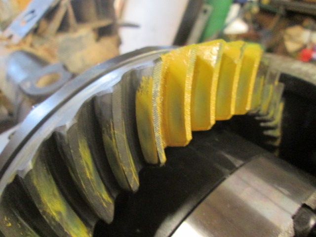

Final backlash taken in three separate locations all read .006 (Spicer .005-.008 spec +/- .002 each; Yukon spec .006-.009). (In the first pic you can also see the air hose routed from the bulkhead fitting thru a clip captured under the top right bearing cap bolt, and clamped to the spigot on the apply piston.)
…and the final pattern checked good, too (drive side followed by coast side).

Also on the agenda for tomorrow is to unload the Jeep from the trailer and get it inside to start yanking the D35.
I finished up the night by cleaning/wire brushing the cover bolts and installing the drain plug with some Teflon pipe sealant. (The cover is just installed loosely here as a dust cover for now, although I still covered everything up with plastic garbage bags and moving blankets like I have been doing all along to keep shop debris out.)
