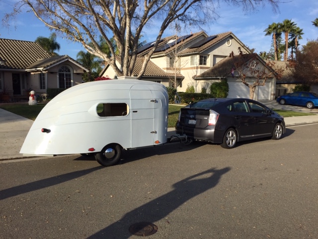

Here's my answer to the problem! Kinda shaped like a Bowlus in back. Still finishing it, so I really don't have any numbers yet.

Postby rjgimp » Tue Mar 12, 2019 3:21 am
Richrad wrote:I like to build wood boats. This is basically an upside-down boat.
So how is this trailer built? It almost looks like a canvas skin over a wood skeleton.

Re: Aerodynamic drag help
Postby Aguyfromohio » Tue Mar 12, 2019 10:17 am
Richrad wrote:Here's my answer to the problem! Kinda shaped like a Bowlus in back. Still finishing it, so I really don't have any numbers yet.
Very nice.
It looks to me like the aerodynamics on your rig are about as good as can be done and still be practical to keep some usable space inside.
Nicely rounded front corners; tail tapers gradually both vertically and horizontally.
Did you cover the underside of the floor to make that smooth too?

Postby Richrad » Wed Mar 13, 2019 12:29 am
I built it in a canoe process called “glued lapstrake”. Basically you build a form, then bend long strips of 6mm plywood over it. Each strip is epoxied to the last one as you go. Then pop it off the form. I didn’t fill underneath since the frame is only 2x2” tube..
