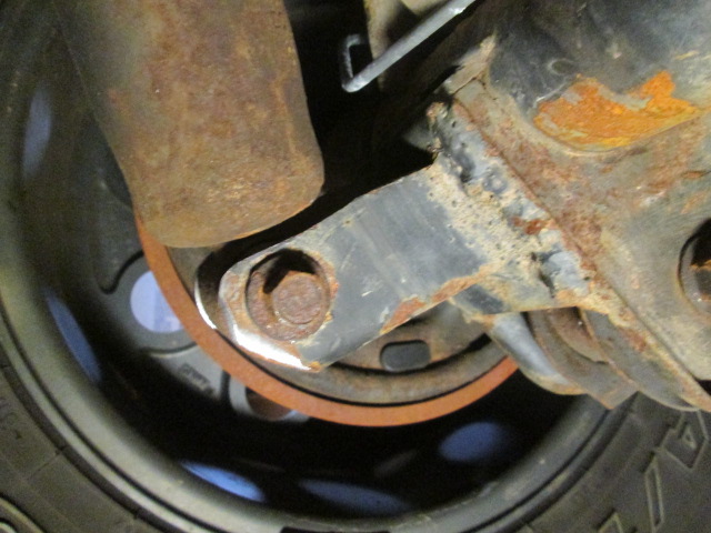

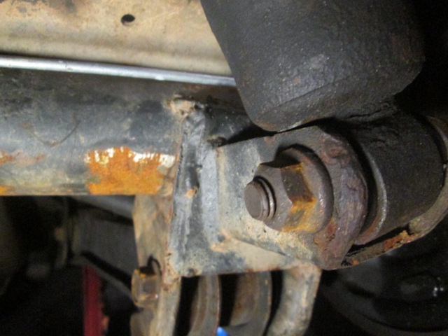

One thing I also wanted to address was the shock mount angle. The PO had a higher lift, so the shock mount angles tended to twist the rubber bushings a tad at ride height. Ideally I would cut the mounts off, turn them slightly and weld them back on. Here, on the passenger side, you can see how the twist left minimal clearance under the end of the shock body, just enough to chafe a bit of the paint off the bottoms of the shocks in normal driving.Image
This is the driver’s side after unbolting the lower portion of the shock; contour sanding the top inboard edge of the mount down using a flap wheel in the 4-1/2 inch grinder; and bolting the shock back up.

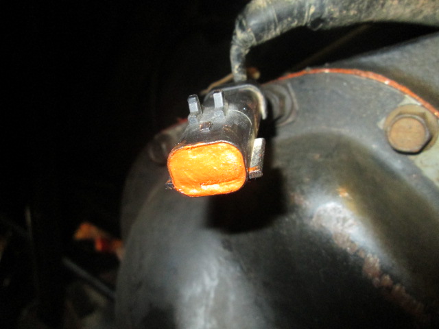

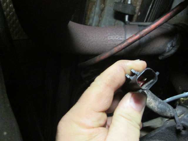

I still haven’t gotten around to installing the locker air pump; installing/wiring the activation switch in the dash and indicator light for the diff mounted switch that senses when the locker is engaged; or plumbing the air line, but the weather is starting to turn and I wanted to at least plug up the harness connection for the diff switch so that the leads don’t get all corroded. Here’s the end of the two prong connector.

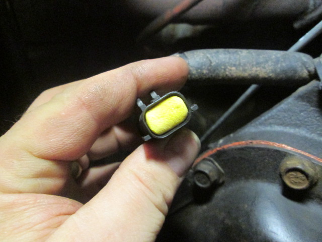

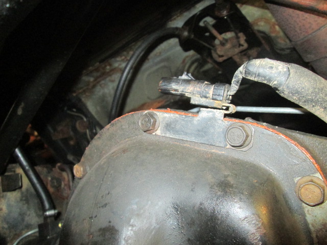

I stuffed an expanding foam ear plug in the connector sideways to act as a filler…
… then smeared over it with a cap of Ultra Copper RTV sealant.
This way I can easily peel the sealant off and pluck the foam out when the time comes to hook it up. Here is the connector hooked back onto its little mounting tab.

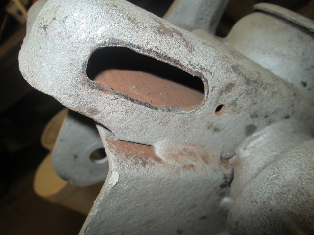

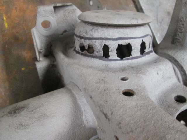

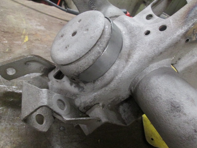

After blasting you can see the trouble areas better. These probably would have never been a problem if I just chose to ignore them, but I found that thought to be, “unacceptable”. After all, I am here, and this axle isn’t as much of a rush job as the rear was.

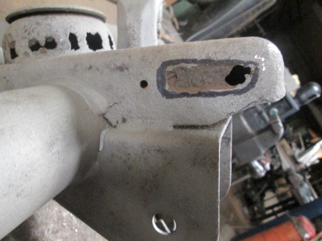

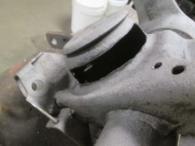

It was kind of strange. Although the front shock mounts each consist of two nested stampings (essentially a shallow ‘C’ within a deeper ‘C’ forming a box section with both sets of toes down and flush at the bottom), and the rust only occurred in the side wall of the top piece, it acted like it was two layers rusting; first thru the outer portion and then starting into the inner “layer”. I also saw this effect on the spring perch ‘hat’. The best I can figure is that this is a result of stress in the metal grain as a result of the deep drawing process when these parts were stamped. It’s as if the inner most fibers, that took the least strain when drawn out, were the most susceptible to rusting.

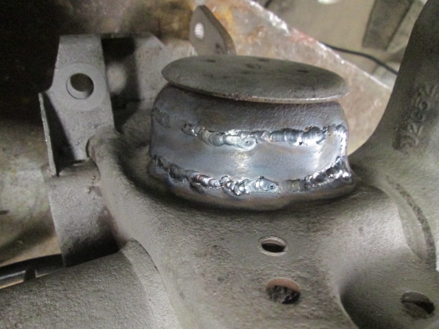

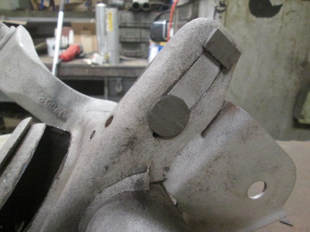

Here is the inside wall of the passenger side shock mount marked for cutting. At the top you can also see the spring perch hat where it rusted thru.
Here’s the same area (mirror image) on the driver’s side after cutting the bad stuff out.

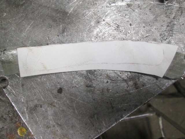

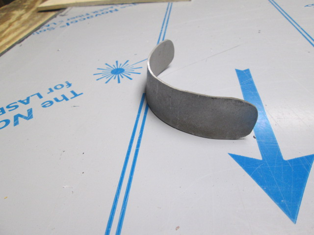

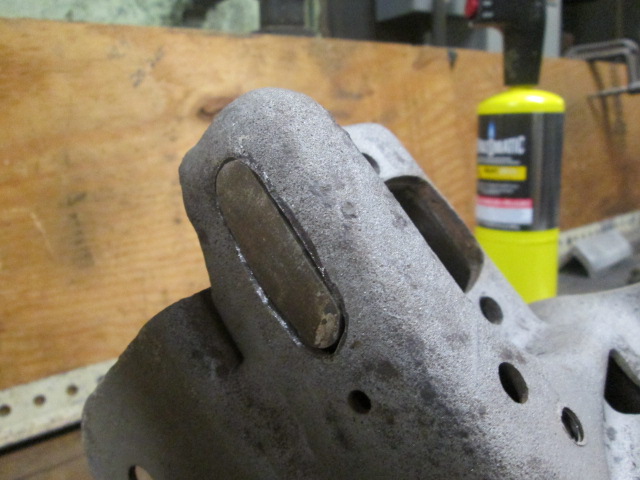

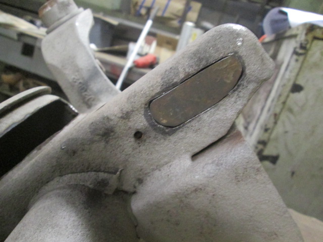

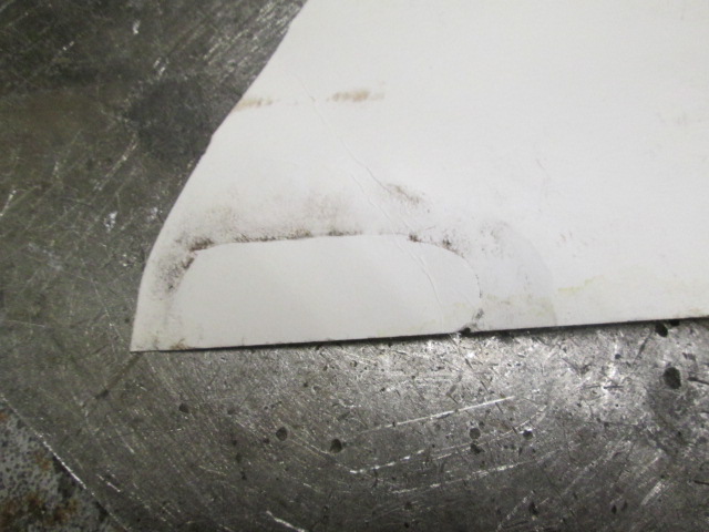

I used a piece of card stock (scrap toothpaste carton material) and the hammer technique to mark a template for the patch piece. You can just see the faint outline made by holding the oversized piece up and tapping around the opening with a ball peen hammer (or small slug of brass where the hammer wouldn’t fit).
After cutting out the template with scissors; transferring that to a piece of 1/8 thk steel stock using a sharpie marker; rough trimming that to shape on the big Do-All vertical band saw; and tediously doing the final fit using the big belt sander, and a file, the plug fits the hole pretty well… snuggly enough to hold itself in place. Yeah there are a few uneven gaps, but, “if I can walk across it I can weld it!”.
Here’s the other side also ready to weld.

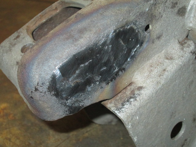

I stuck a couple of magnets on them to help keep me from nudging them thru with the torch or filler wire, just long enough to get a few tacks on.
There were a few areas where the surrounding metal was a bit thinner than the patch… partly due to the stamping draw and partly due to rust… so I made sure to lead and hold the arc on the thicker patch piece, and just weaved over to the edges of the bracket long enough to progress the puddle along (i.e. heat control). Here are the two patches after welding and a little touchup grinding with a flap disc. Nothing crazy, just knocked down the areas that had extra filler; by keeping the heat on the thicker metal I knew I had good weld penetration along the edge.

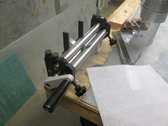

Template was first rough cut and hammer transferred, then transferred to some 1/16 bare steel.
Here’s the slip roller in action. By varying the gap between the two idler rollers (on the bottom) and the crank roller on top it is easy to form curled shapes. By varying the parallelism between the rollers you can form conical shapes. The trick is to creep up on the shape you want by trial and error.
I’m happy to say that it was more trials and no serious errors!

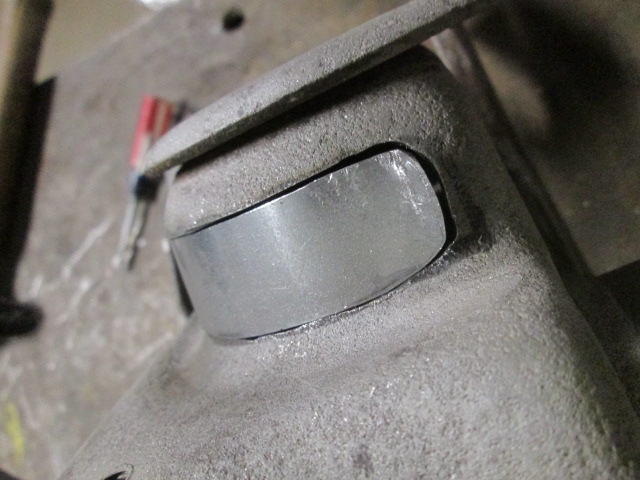

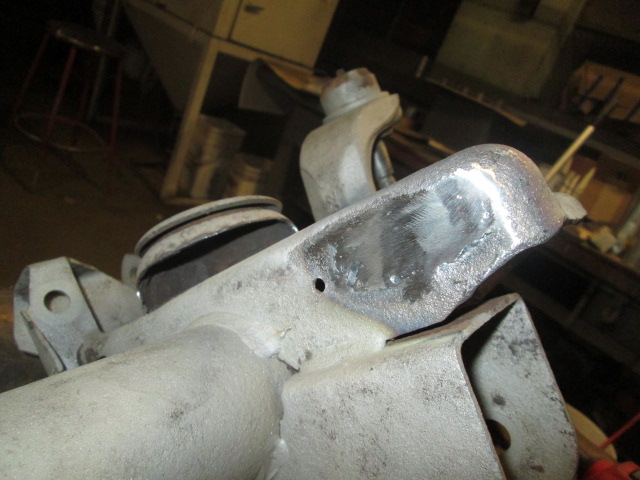

After a lot of fitting, tedious filing and just kissing the patch piece here and there with the belt sander, then going back and forth to the roller a few times once the piece started to fit well, I had it close enough that it mostly fit and held itself pinched into place, except for the far end… which I was confident could be tapped down into place once I started getting some tacks in place… “heat and beat”.
This pic taken during the fit up stage makes the gaps at the closing end look worse than they ended up being in the end. With the piece up out of the hole at one end or the other it didn’t quite match the true radius until it was tamped down in at both ends, at which time it grew to fit better.
Here it is after welding. I ended up struggling to get the last little bit behind the dampener bracket, and it was getting late, so I packed it in for the night and came back to it this evening. I moved the housing over to the other welding bench that is setup with the smaller TIG torch and finished that last little bit of welding behind the dampener mount.

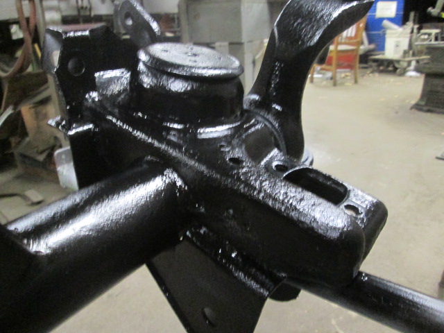

I wanted to make sure that there weren’t any weld bead nubbies that would poke on the inside edge of the spring creating any stress or chafe points, so I went to the trouble to grind the high points down using a small stone disc on the die grinder.

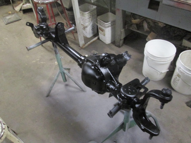

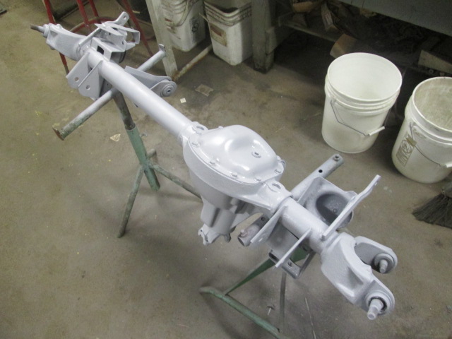

Then it was two coats of Rustoleum gray primer, followed by a good solid coat of satin black.
What weld repair?
Actually, if you look closely in person you can still find the repairs, and I’m not actually trying to hide anything, but I am quite pleased with how well it has turned out.
Now I can get on with the gear setup and assembly.

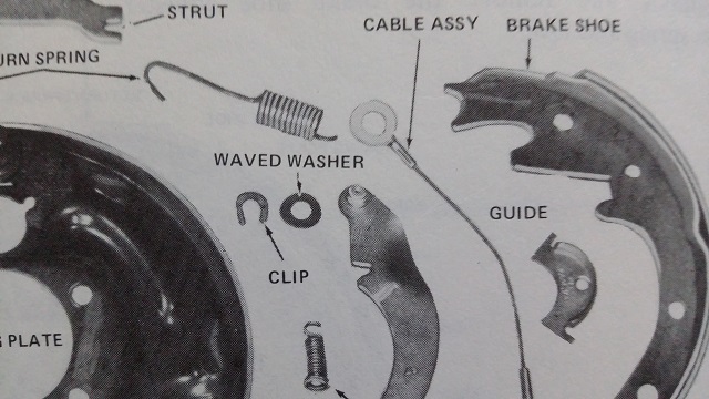

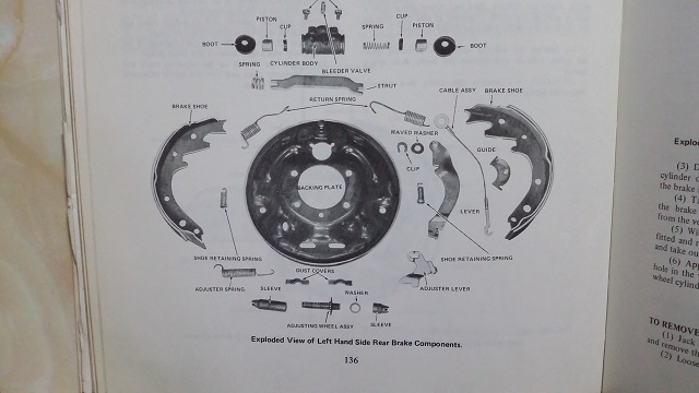

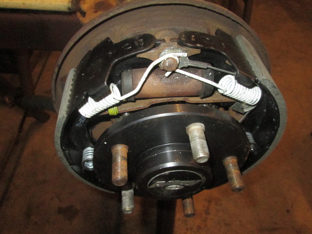

KCStudly wrote:Here’s the new driver’s side axle with the new shoes and spring kit installed.
I’ve done plenty of brake jobs in my time, but hadn’t ever done one with this “modern” style of cable operated adjuster. I took plenty of pictures for reference purposes while taking the D35 apart. Still, included in the new hardware/spring kit were a couple of horse shoe shaped clips and wave washers that did not come out of the OEM assembly. I tried to search on-line to see what I was missing, apparently they weren’t important enough to warrant mention. I thought the horse shoe clips might be a throw away tool for setting the shoe retainer spring cups on the pins using vice grips, but they didn’t fit in the detents inside of the spring cups (I have the driver tool for this so used it anyway). The wave washers are still a mystery.
I was amused when you refered to these as "“modern” style of cable operated adjuster." I was working on them when I left school in the early '70s. The wave washer and the horse shoe clips go on the pivot pin where the hand brake leaver attaches to the brake shoe. Just slide it in to the slot at the end of the pin and give the ends of the clip a little squeeze. Did you get the hand brake adjustment issue sorted?

I was in the shed this afternoon fitting brakes on to our teardrop. :thinking: As brakes were on my mind I was reminded of your jeep, so I thought I should check out my collection of repair manuals, :roll: and sitting on top of the stack was this one on the Australian Chrysler Valiant. 8)
Sure enough when I checked inside I found exactly what I had mentioned to you this morning and thought you may be interested to see these photos. :pictures:

Thank you Sheddie for taking the time to post. That explains it; they are in fact extras for my application. My parking brake levers don't have a pivot pin like that. They have a bent tab that slips into a slot on the shoe rib, so no harm no foul.
I've always been a Chevy guy, which have a slightly different parking brake adjuster w/o the internal cable arrangement, but with a couple of different dedicated springs. It wasn't hard to figure out how it needed to be, tho, just "new" to me. :lol:

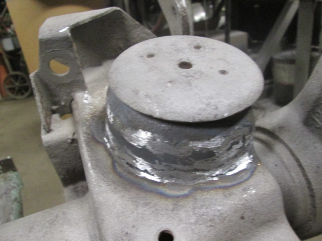

Anyway, the outer knuckles that came with the HPD30 were crusty and rusty (PA salt ridden vehicle). I ran them thru the blast cabinet taking special care not to blast the unit bearing pilot holes, ball joint and steering tie rod end tapers too aggressively. What I found was that the spots where the brake pad tangs bear on the knuckle wings were pretty well worn/rusted/wallowed out. This is pretty common for TJ/YJ/XJ's and can cause the pads to hang up, cause the brakes to pull to either side, and/or not work well.
Given that I want to have the "new" axle already to swap in, and I can't really rely on the existing axle knuckles, with 175+ K miles on it to be in great condition anyway, I figured I either needed to fix or replace these.
A little Jeep forum exploration was reassuring. I found that the knuckles are nodular iron, and that it is common to weld these areas with some SS or even mild weld cladding and then grind it back. The guy who does the Vanco brake mods seems to be the "expert" and warned that welding on the iron brings carbon out, resulting in harder material that can only be dressed with grind stones, abrasives, and maybe just a little with files. Other commenters recommended hard cladding alloys and pre/post heating, while the Vanco guy was adamant about not over complicating things.
I took it all in consideration, and knowing that we had some hard cladding TIG wire at work, researched that. 6010 was recommended and is a high nickel alloy specifically listed as compatible with iron and steel alloys for hard surfacing. What we had was NI 625 Inconel from Washington Alloy. I looked it up and it didn't really say anything about iron or steel, but my coworker/machinist friend said he had specifically sought it out for this type of thing and had good success using it to restore steel shafts and other hard wearing surfaces, that it welded very similar to SS. So I decided that I would try it. The worst that could happen is that I would waste a couple of hours and end up spending another $250+ on new knuckles.
Well it worked out pretty well. No pre or post heat, TIG instead of MIG and it welded just fine. I used a combination of the die grinder with a good sized cylindrical stone and a Dremel with small cylindrical stone to dress the raised cladding back to the nominal surface. Then some coarse emery wrapped on a file to flatten. Let me tell you, the Inconel is wicked hard and will never rust no how. This is the stuff that internal combustion intake valve stems (hard) and sea water valve stems (corrosion proof) are made of.
I got picky with some of the under cuts and did a second evening round of weld pick up and grinding while waiting for the new calipers and pads to come, but once they did I realized that the clearances were generous. A test fit found everything to slide together nicely with no fetching up, so I consider it to be a design improvement upgrade and save (i.e. even if I had spent the money instead of the time I would have still been right back were I was... now I have solved the design flaw and should not have to worry about it again).
So tonight I masked off the areas of the knuckles where the pad tangs ride, the lips inside where the unit bearing OD's pilot, and each side of the ball joint and tie rod end tapers. I used blue masking tape and a 1/2 inch flat washer as a template to trim the tape with razor knife, but only wherever I couldn't use the 'hammer' method to trim the masking tape along sharp edges of the casting. Then I primed and painted them using the left over paint from the axle housing.
