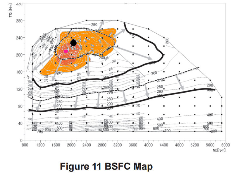

I have some experience with fluid dynamics also, and think it's likely that in some instances a low in height well formed teardrop could improve the overall aerodynamics of the combination. From skimming through, I'd give a kind of spitball of if your coefficient of drag is no less than about 0.4, your frontal area is no greater and the trailer is lower than the aerodynamically significant trailing edge of your vehicle, then you might have same mileage or even gain a tad. By a.s.t.e I mean where the bulk of the air departs the vehicle, for older trucks that may be the top of the cab, whereas with newer trucks it could be the top of the tailgate. For slippier sedans it would be rear edge of the trunk, but for some it might be at the roofline.
However, infernal combustion engines are stranger devices than most imagine, nothing is linear. Completely counter-intuitive is that your engine is not necessarily the most efficient at the speed where you get the best mpg, maybe for small 4 cyls, not so much for anything else. This is because efficiency, which is consumption per horsepower actually produced, and usually quoted technically as pounds of fuel per horsepower x hour, varies with load as well as engine speed. This is known as Brake Specific Fuel Consumption, if quoted as single figure it is peak value and not necessarily anywhere near peak output or peak torque.. https://en.wikipedia.org/wiki/Brake_spe ... onsumption
Now then, this can mean that a lightly loaded engine, like a big one, not pulling much, can be in a bad area for BSFC, only 30HP may be required to bowl it down the road, but maybe at this RPM and only 15% of it's rated output, it's sucking a particularly inefficient 0.6 pounds per HP x hour. Now if we place a higher demand on it 40HP, by dragging something, at the same speed, it might move into a more favorable area of the BSFC map, and only demand 0.45 pounds per HP x hour. So what is the fuel consumption per hour in the first and second case? Both identical, 18 pounds an hour, sorcery you say, no a direct consequence of the laws of thermodynamics as applied to internal combustion engines.
In the case of a smaller engine, it might already be near the best BSFC efficiency, it's more highly loaded, say 30% to produce the same output, now we might presume that in an "economy" car, the manufacturers have arranged this very thing, that at typical highway speeds it's in a good area on the BSFC map, by the design, valve timing and all other factors, with another passenger or two it might not change much, however, double it's load, by making it move twice as much, and it might scoot right over that good area of it's BSFC map and off the other side, resulting in higher specific fuel consumption per horsepower and getting very bad gas mileage overall.
However, this all jumps back to the aerodynamics again, the less change there is in that, the less change in load, with some outlier situations with lightly loaded large engines that there is wriggle room in the science to actually gain mpg with worse aero, and also lose mpg with better aero.

Postby JaggedEdges » Mon May 02, 2016 12:22 pm
Adirondackersouth wrote: I wonder if my Highlander is at optimum BSFC?
If you have the 6 cylinder 2GR-FE engine, there was some discussion "around" it at the Tacoma forum, with this BSFC map..
Gets interesting from post 109, NSFW warning for language here though... https://www.tacomaworld.com/threads/201 ... 512/page-6
Not sure you have the same gearing, but you could compare your final drive ratios and mentally interpolate.
EDIT: BTW the 2GR-FE is in bold over the top, think the intent of the image was to show how they made the hybrid engine better, the numbers refer to that one, more detail in that thread.
