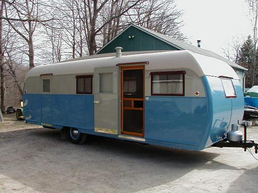

I think you need to allow a "comfortable amount" of distance to allow for backing, but you don't need to be able to have the teardrop centerline 90 degrees to the centerline of the tow vehicle. I can get about 60 degrees of pivot in backing my teardrop. With the short wheelbase of the teardrop this is more than sufficient to back into any camp space. Extra tongue length, though, will make backing of the teardrop easier to control.
If you look at the trailers below, the short tongues would only allow a "swing" of about 30-45 degrees.

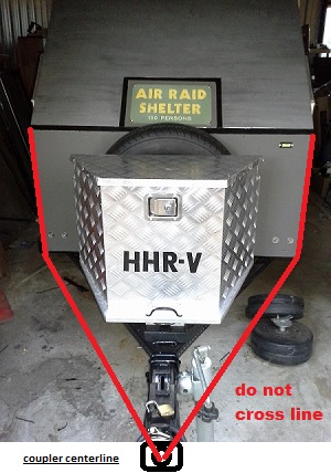

+1 on that info, Rob. I didn't add a tonguebox until I found one that would fit inside my designated "no cross line", which I show here:
Before finding this box, others would have protruded beyond the interference line (in red), and could've presented a problem. Of course, a radical turn could cause the TV to strike the cabin itself, but not the box, even if slid forward on its' linear bearings.114136114026
