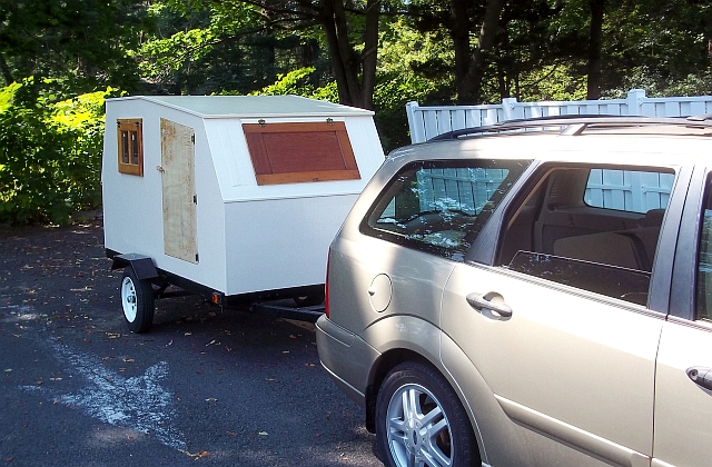

What about a basic answer for a harbor freight trailer
I have the folding trailer 1195 lbs. max load....trailer is loaded and all weighs in at around 980 lbs.
Tires indicate: inflate to 60 PSI ?
too much.??
I haven't towed before.... :o
best regards
Franco
Franco Novo
Posts: 51
Images: 48

Postby Franco Novo » Thu Sep 17, 2015 8:51 am
Towing newbie seeking simple answers
yeah, well, I have one of the cheapo chine trailers from HF and it's already built, I'm a newbie, and a bit nervous about towing.
you all had it once...Fear of towing.... :shock:
there is a bit of a story or formula or haughtiness in many responses, when some of us are just trying to find out an answer to questions you all had at one time
or, maybe it's just my nature of over researching...could be that. who knows
OK..I 'm thinking like...".OH....990 lbs loaded. small cargo trailer, pulled with ford focus....how about 45 PSI." :roll:
Now, moving on: Bucking: Surging: Push Pull" ....???? I am about to redo the sloppy hitch again...Perhaps reading here is making me overthink everything
But, there are new guys, and gals out here who don't really know what towing feels like. a small trailer like that I have...and I can feel it...pushing and pulling on the car...I know the back end of the focus wagon is soft.. I'm playing with loading weights and tongue weights now
Last night I read on some other forum, dig this.... that the bucking or push pull could be. " loose trailer coupler" , loose hitch bar in receiver, loose ball, bearing that is stuck, could just be the type of road I'm on, could be the tongue weight is too much, could be the tongue weight is too little. could be a harbor freight trailer...I need a trailer with 16" tires and a Dodge hemi to pull it
You see why it's dangerous to read forums....I did find another forum, you can write me if you want, i'll give you newbies the name, there is a section on people helping people...that is not full of code and formula's and overbuilders who spend four months joining a sheet of f*ckn plywood with a cnc router, when it can be done in half an hour with a scarf joint or a block and some glue and screws.
Franco
