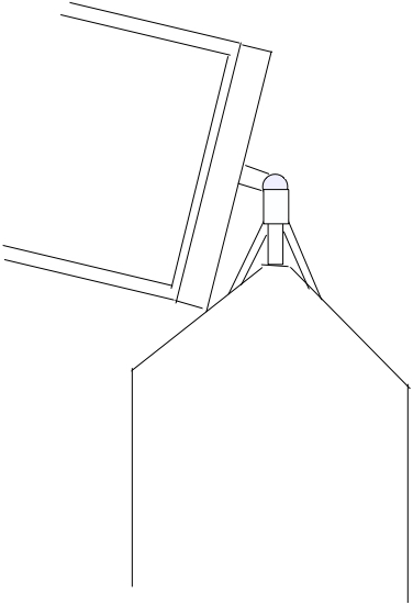

I've got a cargo conversion. 14 ft. Aluminum. Don't know the weight but it's not too heavy. Thing is the distance from the hitch to the trailer is about 10" too short. When I turn sharply the end of my bumper will hit about 10" back on the side of the V nose of the trailer. If the hitch were a little longer it wouldn't be able to hit. Yes, I have a dent in the diamond plate of the trailer when I turned sharply while backing into a campsite.
Here's a crude drawing of my dillema.
I called the company that made the trailer and they said that they couldn't extend the trailer tongue (aluminum) and have structural integrity. They suggested I extend the hitch which would help I guess.
Right now my hitch extends about 6" If I got a 10-12 inch extension for my hitch to extend the ball out away from the back of the truck would it be structurally sound and not put too much weight on the towing package of my truck? I've got a Ford F-150 with towing package so it's not just a bumper ball but a trailer hitch.

The pic is what is called Jackknifed. At that angle the tongue /front of trailer is being shoved. Trying changing your backing technique.

If he's trying to maneuver into a tight campsite, its not his technique. I extended the tongue on my camper exactly for this purpose. I can get the trailer at <90 angle to my car, and I've needed to do so many times. Not all campsites are wide open spaces.

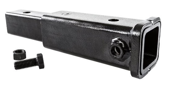

When we had our 26' TT, and the F150, I used the hitch extension shown in the first picture. The only problems with them is that they can be a bit noisy as they are not an exact fit. With mine, I attached the extension to the hitch using a high strength bolt (not the normal pin). I used a type of nut that is kind of like a nylock, but instead of using a nylon insert, the threads are designed to be slightly askew and it takes a lot of real force to tighten down or remove, I mean a lot. Between the extension and the hitch I added in just some simple pieces of rubber that had to be jammed in prior to tightening it down. For the trailer to the hitch, I used a weight distribution hitch with keyed locking pin and the same type of rubber inserts. It was quiet and I towed it thousands and thousands of miles, with no problems. It helps a lot if you find yourself needed to do a "U" turn on a highway or making a sharp backup. As to hitch loading, it really doesn't matter a lot, I believe I had about 700# on the hitch with that trailer, it was designed for 1,000.

If you decide to go with the hitch extender it might be a good idea to use a hitch clamp to tighten up the slop.
I use one like this on my normal setup on the tow vehicle and I'm very pleased.

Wow. Yes, jackknifed is the term. Treat yourself to a cookie. I never disagreed about that. I disagreed with your comment about technique. Some people actually prefer camping out in the great unknown rather than on a concrete pad in the middle of a campground, and therefore some more maneuverability is sometimes needed. Extending the tongue can prevent jackknifing from happening until you get to a much more extreme angle, which is EXACTLY what the OP is asking about.
Extending the hitch, or extending the tongue (same outcome - creating more distance between camper and vehicle), is perfectly acceptable if you stay within the limits of the components.

Deceiver - I searched 2" hitch extension and etrailer.com has a few available in different lengths. The link below is for an 18" extension. The specs indicate its good for 350lb tongue weight. The note below the description says that using an extender will reduce the overall hitch capacity by 50%.
https://www.etrailer.com/Hitch-Accessor ... 45796.html
I think I personally may be a bit weary about using an extension THAT long, but depending on your actual trailer weight it may not be out of the realm of possibility. I'd be more inclined to search out the shortest extension possible that will work for your situation.

I am wary of using any long truck hitch extensions. The extension is a lever arm. The effect is to lighten the front axle and increase the load on the rear. The hitch ball on my truck is about 4 feet behind the rear axle. For the sake of argument, if the hitch weight was 300 pounds that calculates to a force of 300 x 4 = 1200 ft=lbs. If I extend that hitch by one foot we get 300 x 5 = 1500 ft-lbs. An increase of 25%. That would be the same as having the shorter 4 foot axle to hitch ball distance with a hitch weight of 375 lbs. Maybe that would be detrimental, maybe not.
Anything more than a few inches will likely increase the wind twitchiness, IMO. The longer the lever arm the easier it is to move something. The ideal thing would be to be able to try out an extension before purchase. Or at least buy one with return privileges.
Maybe it is not a big deal but the thought of sticking the ball 14" further out makes me nervous.
