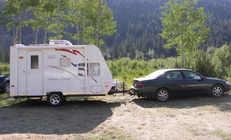

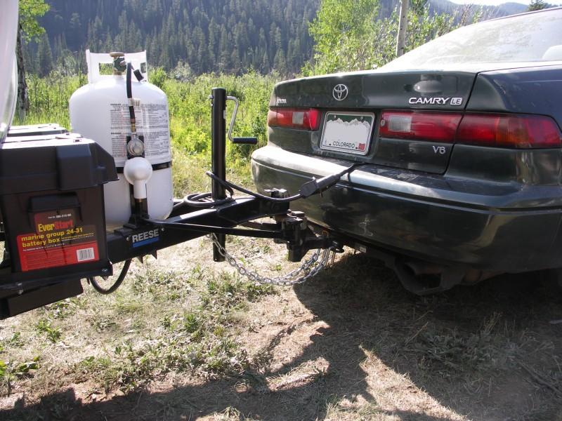

Postby Florida Native » Fri Jul 22, 2016 4:15 pm
Here are a couple of pics of the Camry/not-so-tiny-but-still-small TT...
Camry and small Travel Trailer
Closeup of WDH on Camry
