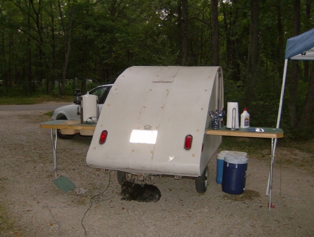

Postby bobhenry » Wed Oct 12, 2016 1:23 pm
If you were close I have what you need ! At 525# loaded ready to camp I have towed it with my Goldwing. Roadtrip and $1200.00 its yours !
and the build link if you are interested !
http://tnttt.com/viewtopic.php?f=50&t=3 ... van+winkle
