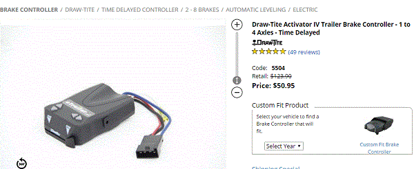

Postby working on it » Fri Feb 24, 2017 1:13 pm
time-delay controller for motorcycles.GIF (24.09 KiB) Viewed 4161 times
E-Trailer has and recommends this controller for motorcycles:https://www.etrailer.com/p-5504.html
