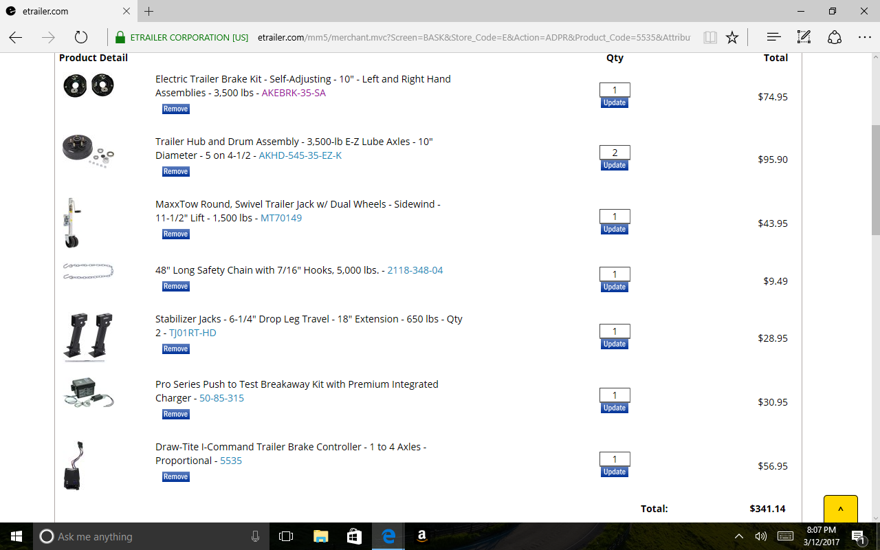

Postby sukig » Sun Mar 12, 2017 7:11 pm
Thanks! There are flanges for the brakes on the existing trailer. I added an activator to my order, thanks! I will be running power to the trailer.
Here's a screenshot of my order, I'm about to do some price comparisons but I think this looks pretty good... Please, let me know if I'm off the mark.

Postby dancam » Sun Mar 12, 2017 7:37 pm
Do you need to wire your tv for that controller or does it just plug in? Do you need different sized plugs on the tv and boat traiker where they connect?
If you plan to tow other stuff withthe vehicle the inertia activated brake controllers are nicer. Time delay would be alright just for a boat though if its not close to the vehicles tow capacity.

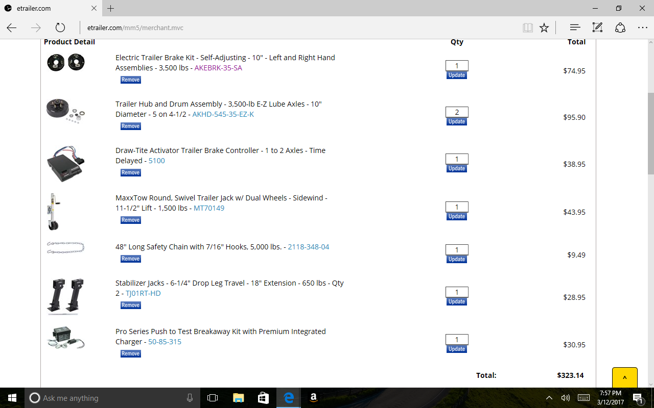

Postby sukig » Sun Mar 12, 2017 7:51 pm
Updated order... Oy, it adds up.

Postby dancam » Sun Mar 12, 2017 7:54 pm
sukig wrote:Okay, I wasn't sure which would be better the inertia or time-delayed. Good advice. I'll check the wiring... that's my weakest topic and I have a lot to learn. The trailer already has 4 pin wiring and lights. If I understand correctly, I'll need to change that to 7 pin, right?
What does your tv have? If its only flat 4 as well then changing it to 6 pin would work as well but 7 pin is way more common and you can just buy cheap little adapters to go from 7 round to flat 4, flat 5, round 5 or round 6. I would go with round 7.
Time delayed sees signal from your brake lights, waits a second, then applies trailer brakes at whatever you set maximum power to.
Inertia based applies brake to the trailer based on how fast your slowing down the tv. The harder you brake the more it brakes the trailer

Postby KCStudly » Mon Mar 13, 2017 6:29 am
Are you sure the big 10 inch/3500lb axle brakes are compatible with your 13 inch tired axle? Check the backing plate bolt pattern and clearance inside of the wheel. You may need the smaller brakes.
Might be worth a call to e-trailer to help you get it right.

Postby sukig » Mon Mar 13, 2017 6:38 pm
KCStudly wrote:Are you sure the big 10 inch/3500lb axle brakes are compatible with your 13 inch tired axle? Check the backing plate bolt pattern and clearance inside of the wheel. You may need the smaller brakes.
My axle is 3500 pound axle and the brakes are for 13, 14 and 15 inch tires. I did some measurements and it seemed like a fit. Backing plate bolt pattern? I'm pretty sure it matches, 4 bolts to my 4-holed flange. I was able to match the drum bolt pattern to my current tires without issue. Maybe I'm missing something... Order has been placed now, though (was making the most of the free shipping yesterday). So, I guess I'll let you know when it gets here and we get into it.
