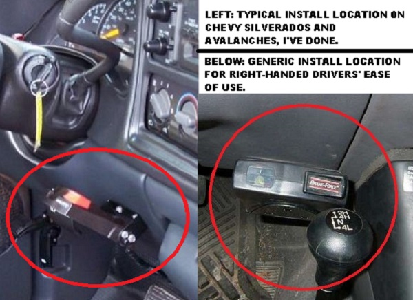

  • I've used time delay braking controllers on all my trucks and on other vehicles I've put them in. My preferred controller is the Hopkins' Impulse, which I installed in my '04 Chevy Silverado, and in my Father-in-laws '03, and in 5 others, all Chevrolet, using the plug'n-play wiring they came with. I put one to the left underside of the dashboard (for a left-handed friend), and the remainder to the right. I angled all of them slightly upwards, and some closer to the driver, per their choice. All have functioned well, for many years (12-13 years, since installed).
  • For other trucks, which I had done before I got the Impulse, I used a Reese Brakeman, also a time delay controller, which I installed on two of my old trucks (and also on my wife's GMC, when I had to replace her failed Tekonsha, and that was the only one I could get immediately-she was leaving in an hour, on a rush insurance call-). They were not plug'n-play, but easy enough to wire up. Both brands of controllers could have been mounted at any angle, but I've found that the "underdash/beside the steering wheel" position has been universally liked by me and others.
    brake controller preferred mounting position.jpg (94.4 KiB) Viewed 10821 times
    easy to see & reach, out of the way install sites

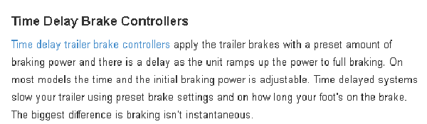

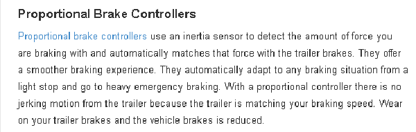

  • Note that I corrected the "timed" to "time delay" description of the controllers, in my post above. It more accurately describes the simple braking action that the controllers exert, a delay before ramping up to the chosen power level. Proportional braking controllers use inertial sensors, and sense and adjust braking power to fit the situation. I've gone "old school" by choosing what I know and trust, the "time delay" kind, where I can choose how much braking I want to use (it can come in handy in slow moving, stop and go traffic, using just manual trailer braking, rather than the truck brakes).
    time delay braking controllers.PNG (9.09 KiB) Viewed 10795 times
    description of time delay function
    Proportional brake controllers.PNG (10.49 KiB) Viewed 10795 times
    description of proportional function
  • Sure, I've locked up my single-axle brakes, when I pulled into a service station after highway travel (I forgot to set the braking percentage to less-aways had controllers on tandem axles before, not a lightweight single axle). You do have to adjust the percentage for varying speeds, loads, and conditions. I was just using trailer brakes on my TTT for the first trip; I wasn't used to it, yet. Though my TTT isn't lightweight anymore (now at 2000 lbs), my truck doesn't really need the trailer brakes to stop it.
  • Choosing the type of controller is up to the user: I chose the time delay. It's what I've always used, and trusted, and can mount anywhere, at any angle, if I choose. Proportional is probably a better choice for light trailers, inexperienced users, varying road conditions; but, they're more expensive, and I think they have to be mounted level (so the motion sensor will function).
