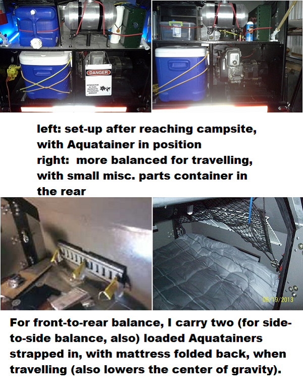

  • Since I was building a small size trailer, a 4x8, and knew I was dealing with a marginal suspension (the original axle had an unknown weight capacity, and I was expanding the 50" x 60" original frame to hold twice what it probably was intended to haul), I tried to distribute loads/components evenly from side-to-side, too. Space limitations also forced me to distribute bigger items as a counter to other large items, with small items strategically stored in the remaining space available. Two large items were designed into my plans, from the very start, that had to counter each other, in my galley area: the generator (w/extended-run fuel tank, added later...in a center-mounted position), and the A/C unit (mounted thru the rear bulkhead wall, with drip pan and exhaust ducting taking up space in the galley. The generator and slide/turn mounting weighed about 80 lbs, so the A/C and associated components, should weigh about the same, ideally. But, most of the A/C's weight is forward of the generator's, though the side to side balance effect is similar. I utilized room under the drip pan as a home for my Aquatainer water dispeser, at camp, though it weighs too much to transport in that position. Still needing some more left-rear corner balance, I at first put my battery there, then after moving it to the tonguebox, put a 5-gallon fuel jug there (I decided that that might not be the best spot, directly in front of my main 12vdc cut-off switch, and replaced it with a cooler). I filled in the remaining available spaces with Coleman gear, and 110vac surge protection and a fire extinguisher, to achieve an all-around balance, of sorts. The aquatainer rides to camp (with another, as extra water, and both serving as a tongue-weight enhancer, also compensating for the already heavy components permanently stored/installed in the galley.

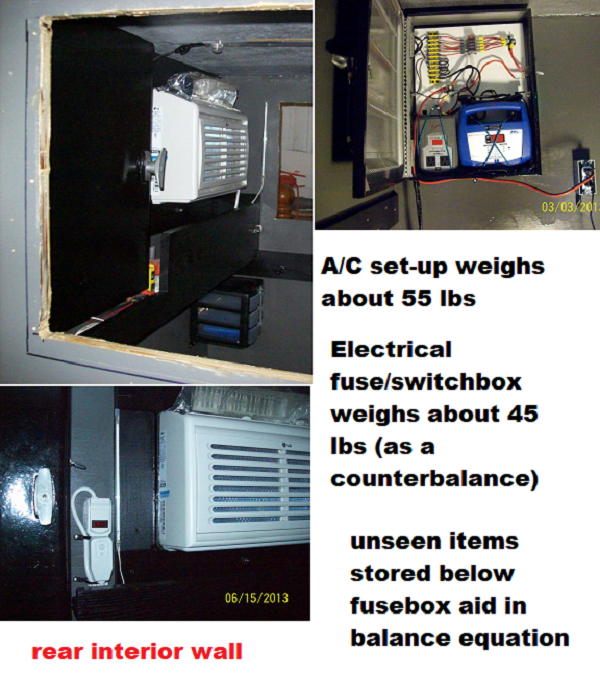

  • Inside the cabin, I followed the same thought process, and balanced front-to-rear, with a forward bias, and side-to-side, as best I could. Because the A/C unit was already taking up space, high on the streetside rear wall, I used an old keybox, transformed into a 12vdc inside-cabin fuse/switchbox combo. It was heavy enough to nearly compensate for the A/C weight opposite it, and again, I used smaller items to better balance the equation, inside. As mentioned before, the front cabin wall is where I strap-in my Aquatainers for travel, using an e-track, for balance. On the return trip, if both containers haven't been emptied, I put the heaviest one on the streetside, diagonally opposed to the heavy generator in the right-most rear corner.

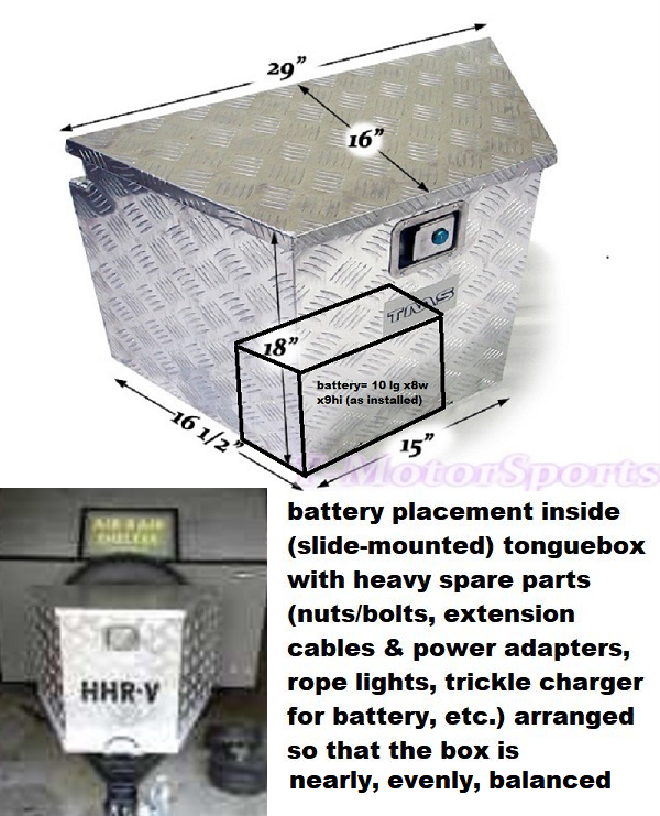

  • Moving forward, the tonguebox is as evenly balanced as I could make it, with equipment and heavy hardware stored inside,
    as well as the battery. Mounted on a sliding plate on the single-beam tongue, I used outrigger stabilizer struts, and a roller-on-runner support system underneath, to guarantee no weight shifting on the road. The spare tire and wheel are mounted directly behind it, in a neutral balance spot.
