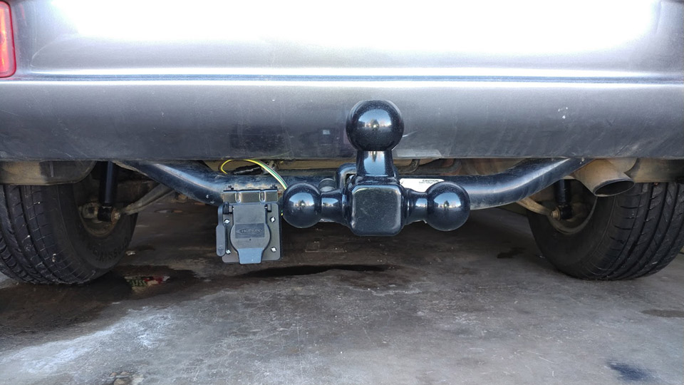

My 7 pin install is screwed into where the 4 pin was. But one of my worries is, it is below the hitch. 9" from the ground. Hitch is 11" from the ground. If I bottom out it will be the first thing to go. ( not that I am planning on it)
There was a 2 inch drop 2" ball on there and I had to get a larger 2 5/16" and I went with no drop. Does this matter?
I almost installed the 7 pin on the right side but was not sure if that would work. I always see them on the left.
Not sure if I should risk it or try and figure out a way to raise it up. If I could find some sort of spacer I may be able to get it 2" higher with longer screws. Below is a pic. I put new rear shock on as one looked like it was leaking and did not want to chance it. When I stand on the hitch it does not go down much and I weigh about 200 lbs.
Also wondering if anyone know a good highway that runs parallel to I -70. ON our last trip to AZ we took 160 that goes over Wolf creek and it runs parallel to I-40 and it was dynamite. Highly recommend it. I hate 1-40 because of all the truckers. Hoping an empty trailer will not bounce around or get blow off the road when a trucker passes me. :shock:
Below is a pic. Thanks in advance for any advice.

Postby pchast » Mon Jan 22, 2018 10:16 pm
I would not leave the connector there. Can it be mounted above the bumper/hitch somehow?
