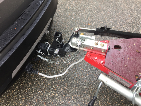

I have the standalone friction type anti sway bar. It requires some drilling to install it. I didn't want to drill holes into the frame of my trailer so I welded the receiver ball onto the side of the my trailer. I have about 5000 miles with this trailer already and so far so good. I don't use a weight distribution hitch so I can't really share my experience with it.

Friction sway bar
Trailer

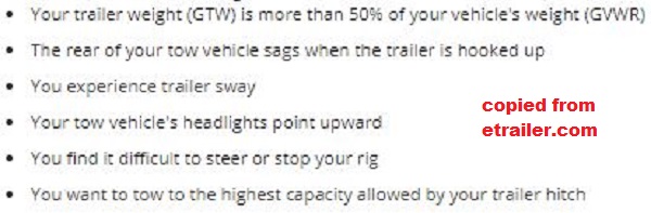

* Here's a quick checklist to help anyone decide if they should look into Weight Distributing Hitches and Sway Control
reasons to install a Weight Distribution Hitch system.JPG (47.45 KiB) Viewed 7218 times
* I've used both on many trailers over the years, and I always have them standing-by, if I even only tow a short distance, just in case. I've had overloaded trailers, improperly loaded trailers (loaded that way by necessity, not by choice: too light on the tongue or too heavy on the rear), and with trailer axle too far forward, and/or the ball-coupler too high in relation to the trailer rear, or tow vehicle too light compared to the trailer load. In any or all of those situations, I was able to tow successfully, without sway, due to using WDH and Sway Control.
