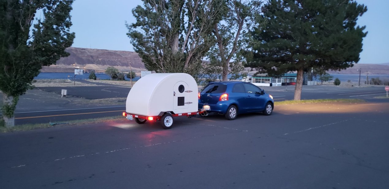

Postby robhwashington » Mon Mar 15, 2021 5:48 pm
I made this foamie for mine in March 2019. The whole teardrop (including the trailer) weighs just under 400 lbs. It pulled fantastic behind the Yaris (I could maintain 60 mph on a 6% grade), however I ended up getting a CRV and it rides behind that now. Even though it pulled fine, I too got concerned about my insurance because of the official Yaris tow rating......
