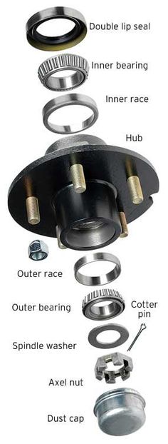

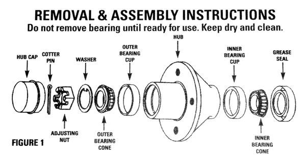

pictures would help
here are 2 pics of the parts in a trailer hub
yours should look like one of them
if you don't have the tools to remove and pack the bearings take the trailer to a reputable mechanic to have it done
if you don't you will worry yourself silly on the entire trip
sw

Honestly I wouldn't worry too much about 5 degrees temperature difference. That can easily be explained by the sun shining on one side. I drove semis for 25 years. If a hub is cool enough to keep your hand on it for ten seconds or so after driving for an hour there is really nothing to worry about. Stopping regularly is a good plan. Check the temperature at every stop. If something gets "too hot to handle" use those images swoody provided and do a roadside rebuild. Better yet, stop at a hardware store and get a set of Bearing Buddies. They are a replacement dust cap with a zerk fitting so you can add grease to your bearings using a grease gun and not make a huge mess.
