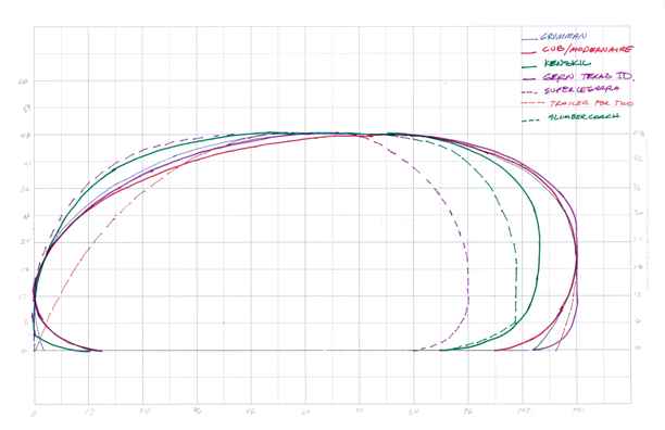

Postby aggie79 » Mon May 10, 2010 7:52 am
dontpanik wrote:I can't do CAD and for some reason I am Sketch-up intolerant. I need graph papers and pencils....do they still make those?
Welcome to the non-CAD club. I use this site here to make my own graph paper: http://incompetech.com/graphpaper/square.html
When I was trying to decide what profile to build, I sketched several from the design library:
I finally came up with this profile which is a hybrid of two designs with some of my own sketching thrown in:
