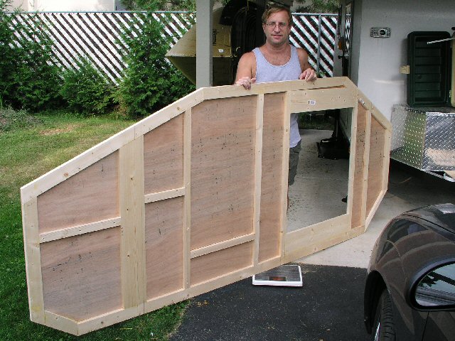

Postby mikeschn » Sun Nov 06, 2005 3:14 pm
These are homemade SIPs. No glass of course.
The biggest problem with SIPs is that you don't have any material in there to bolt your windows or doors to. So you'll want to add some framing in the area of the doors and windows.
Hmmm.. You'll also want to add some framing in the area of the cabinets and the galley. And don't forget to add framing around the edge for your roof spars.
By George, I think you'll end up with something similar to this...
Mike....
Postby Chris C » Sun Nov 06, 2005 3:20 pm
Hey, Mike, good looking side for that trailer. Also glad to see the new avatar! (couldn't help stickin' that in there) :lol:
I agree that the foam wall would provide no attachment points. Yes, it would make for a light trailer....................extremely minimalistic and spartan, but I can't see how it would be of much use other than basic weather protection.
Chris :D

Postby BrwBier » Sun Nov 06, 2005 8:38 pm
I guess their is something you dont understand about Sips. The first word is structural. They will hold way more than you think. If you are only fastening your windows and doors to the wood frame then you dont understand how to build a vehicle. The doors and windows have an outside frame and an inside frame, they are fastened to each other, creating a sandwich of the outside skin the foam core and the inside paneling. Very tight, strong and leak proof. The skin, core, and paneling are bonded to each other. My Winnebago, built this way would hold on the roof, an a/c unit and at least 6 people in lawn chairs. As for no place to fasten the spars, I don't intend on using any. If my plan works as designed then the roof will be self supporting. The galley will be a wholly self contained unit that slides in from the rear, like a piece of furniture. All systems will be contained in this section with only electical and propane coming up from conduit in the floor.
